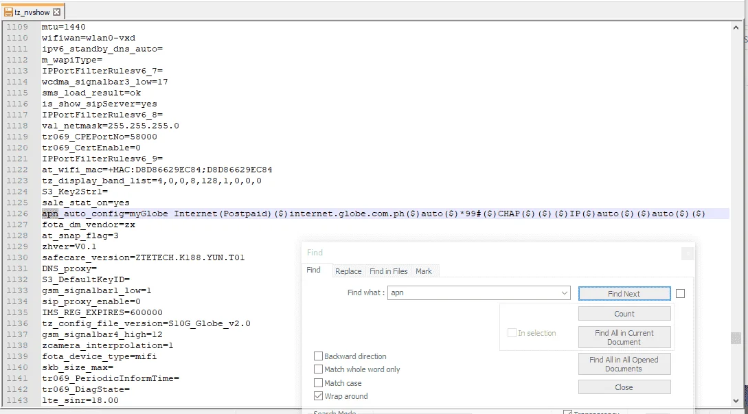

Next time when configuring, best na gumawa ka ng backup. What you need to do before ka magkalkal is punta ka firmware update settings, export mo yung file. Click download. Yun autobackup na yun. Keep a copy of that file na lang para if may magalaw ka, you can either flash that/upload it back or just click the hole(reset button) using a pin sa likod.
