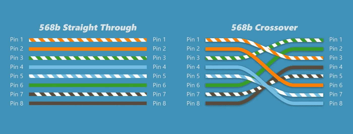

Bossing, sa pagkaka-alam ko pag:
Straight-through, both ends are both 568A (or 568B).
Crossover, one end is 568A while the other is 568B
Hindi pa ako nakaka-encounter ng cabling na katulad ng nasa left. And modern devices does not strictly require crossover cable as they are auto-mdix.
