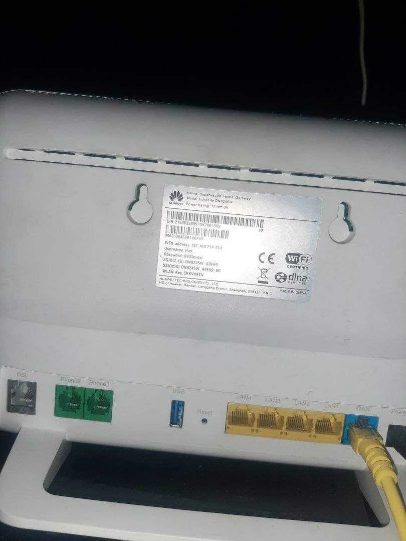

🔒 Closed Model Ecolife DN8245W
meron din akong ganyan boss same tayo gagawin ko sanang repeater sa PLDT. punta ka sa youtube boss maraming tutorial dun
Success, Working yung Globe DN8245W as Wifi repeater/extender sa PLDT DSL RN104R4GC-2T2R-A5 modem.
Process?
1. Open globe modem. go to Lan configuration, change primary IP address from 192.168.254.254 to 192.168.1.3 or 4(depends on your PLDT Ip gateway) then apply/save.
2.Go to DHCP Server Configuration, Uncheck Enable Primary DHCP Server and Enable DHCP Relay then apply/save.
3. Connect your Globe modem to your PLDT modem through UTP cable/Lan Cable. Then Done.
