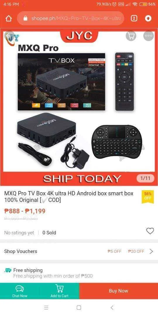

MGA LODS SULIT BATONG MXQ PRO? BAKA MASAYANG KASE PERA MGA LODS!
MAY NAKITA KASE AKO MGA LODS ISANG ARAW LANG DAW YUNG MXQ NILA LMAO! TAS MABAGAL DAW MAG PLAY VIDEOS NILA? ANO SA TINGIN NYO LODSScreenshot_2020-08-13-16-16-25-490_com.android.chrome.webpScreenshot_2020-08-13-16-16-25-490_com.android.chrome.webp
May MXQ kami lods, siguraduhin mo lang na trusted seller yung pagbibilhan mo. May mga ibang seller kasi na nagititnda ng defected na mxq boxes. Laggy siya pero minimal lang, mabilis naman pag Kodi gamit ko.
Kung yung mga old MXQ pro 4k S905X Amlogic devices.. YES it is sulit. kahit 1gb ram at 8gb rom lang maganda performance at Video coding is good.
Pero kung yung mga latest ngayon lalo na yung MXQ pro 4k 5g RK3228A Rockchip devices .. Medyo sablay kahit 4gb ram na at 16/32GB rom pa.
TESTED.
I have MXQ pro 4k S905x 1gb/8gb - 4year old device -ok na ok pa
Just this year bumili ako ng device para sana sa Kwarto, ireceived MXQ pro 4k 5g rk322a 4gb/16gb
di kasing ganda ng performance nung old device ko.
so binigay ko sya sa pinsan ko. tapos nag hanap ako online ng AMLOGIC powered device
and I ended up buying x96 mini S90w 2gb/16gb .. BEST decision .mas mahal ng konti pero Satisfied.
lesson learned.. stay with AMLOGIC devices.. Rockchip are primarily focusing in Low Cost /underpowered SOC.
Hope this will help for future references
good point.. always check reviews.. mas ok kung ang titingnan mabuti yung mga 1 star review. it will give you clues.
Laggy sya kasi Bloated yung firmware(android stock)
Yung old MXQ ko hindi na android ang system .. PURE KODI and nilagay ko(linux)COREELEC system.
Walang LAG. the best sa MOVIES kahit 4k walang lag. Downside is wala ng android apps di ka na makakapag-install kasi di na sya android system(kung ano man kelangan kong apps,, pwede naman ang phone ko)
Mabagal ang specs ng mxq. Meron akong mxq pro yung unang labas na version.
Stock android? mabagal talaga sya sir. marami pa yung Background process na kumakain ng CPU at RAM kesa sa actual application na ginagamit mo.. If i may suggest try Custom ROM if you still want to have android system in your device.. ATVexperience Debloated yung firmware at mas ok ang performance kesa sa Android system that comes with the BOX.
It's not the Device capability problem
It's the System lacking optimization .
hope this will help for future references
Boss naka bili ako ng mxq pro 5g medyo ma lag lang kung mag iinstal pa nang apps pero kung sa kodi ok naman.
