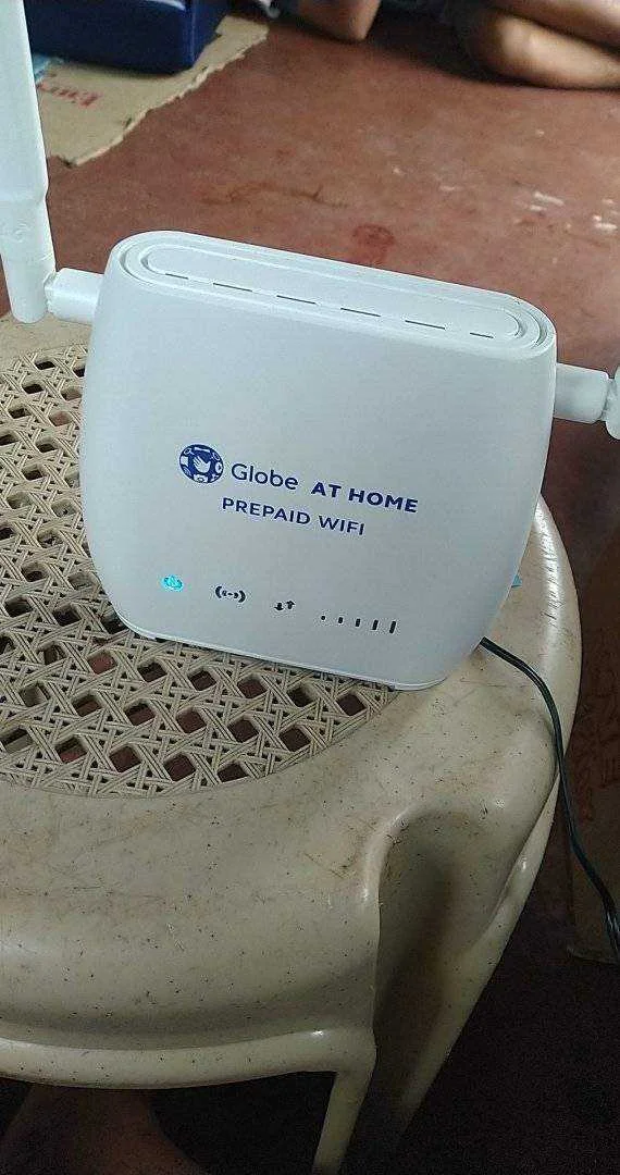

TROUBLESHOOTING DONE:
  • Changed SIM
  • Reset thru Reset Button (NOTHING HAPPENED)
  • Can't connect thru WiFi
  • Can't connect thru Ethernet Cable
PS: Void na po warranty kasi po inopenline ko na sya, nung 25 ko pa lang po yan binili
Try mong Connect sa PC Ethernet cable kung mababasa yung port ng Ethernet pag bumasa re upload mo yung first config na d mo pa na edit at kung hindi parin try Reset button 15 seconds and after off modem at saka on while pushing hard reset button.
Same saakin. may power pero ayaw magconnect . . Buti may backup files ako pero hindi ko alam kng saan irereupload yung file.Tinary ko connect sa laptop using the cable pero di binabasa. Pinatining ko sa technician sabi nya need lng daw nong back up.
