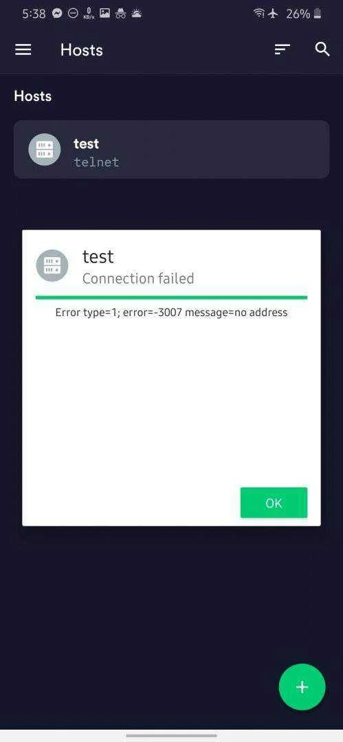

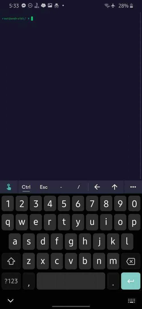

Yung ma-access mo command line ng device. Malaman mo kung naka-open telnet kapag pwede makaconnect sa telnet ng 192.168.X.X
- Download ka:
•Android App: Termius
•PC Program: Putty
- Tapos try mo connect sa 192.168.X.X
•Sa Putty make sure naka check yung telnet
•Sa Termius dapat naka-uncheck yung ssh at naka check yung telnet
- Pag meron nag pop-up na shell open telnet device mo.
•B315s-936 Shell:
@ATTACH,ATTACH]
•B525s-65a Shell:
@ATTACH,ATTACH]
-Kapag eto yung pop-up, closed yung telnet ng device mo, change firmware ka kay sir jerome kapag ito yung error.
@ATTACH,ATTACH]
