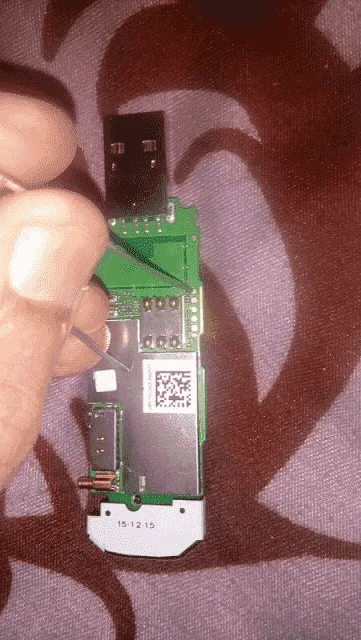

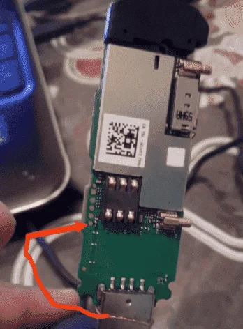

Next, you will need to dismantle the USB internet key and locate the boot point as shown below
Once you have spotted the boot points as you can see above(first image or seconds anyone will do), use the tweezer to link the two boot points and connect to the Computer. At this point when you connect, you should here a sound coming from your computer and the LED should be off.

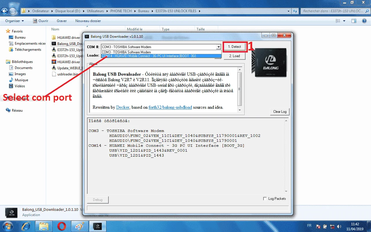

Once connected, you will see drivers installing, and when it's done, note the com port number of Huawei Mobile connect - 3G PC UI Interface from the device manager or you should see it display once drivers have all been installed.

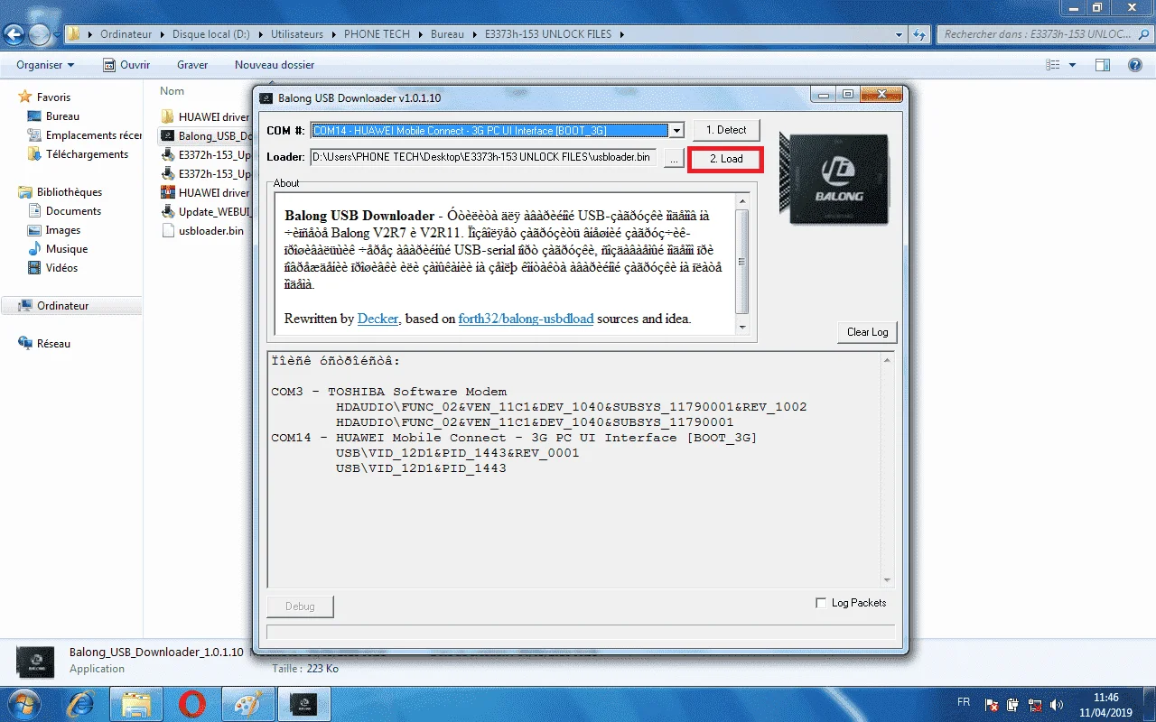

Open Balong USB loader, click on "detect" and select the com port of your E3372h-153 modem.

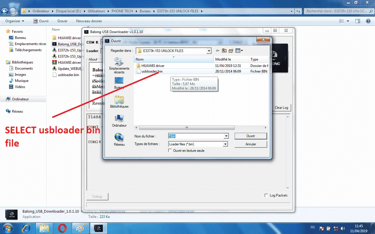

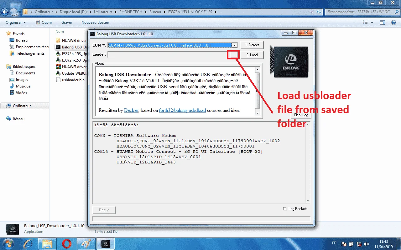

After the above step, click on the "three dots" beside the "load button"

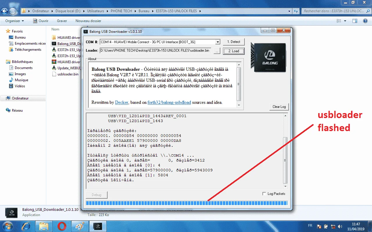

Now, click on the "load" button to flash the usbloader B!n file in order to erase the custom firmware in your internet key.
When the process runs completely without any errors, you should see this
Once you have succeeded in flashing the usbloader B!n file, the LED should start twinkling. At this point, we will need to install the firmware. We will start by downgrading.

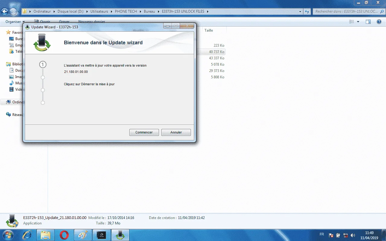

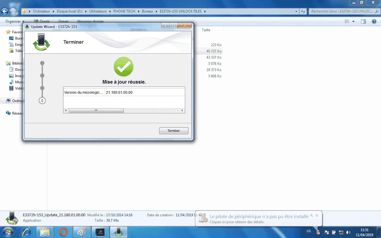

Launch and install the E3372h-153_Update_21.180.01.00.00 firmware
After this step too, your modem should keep twinling(the LED). Unlike the unlocking state where you flash a second firmware update. Here we will stop at this stage. And note that no WebUI will be installed here.
