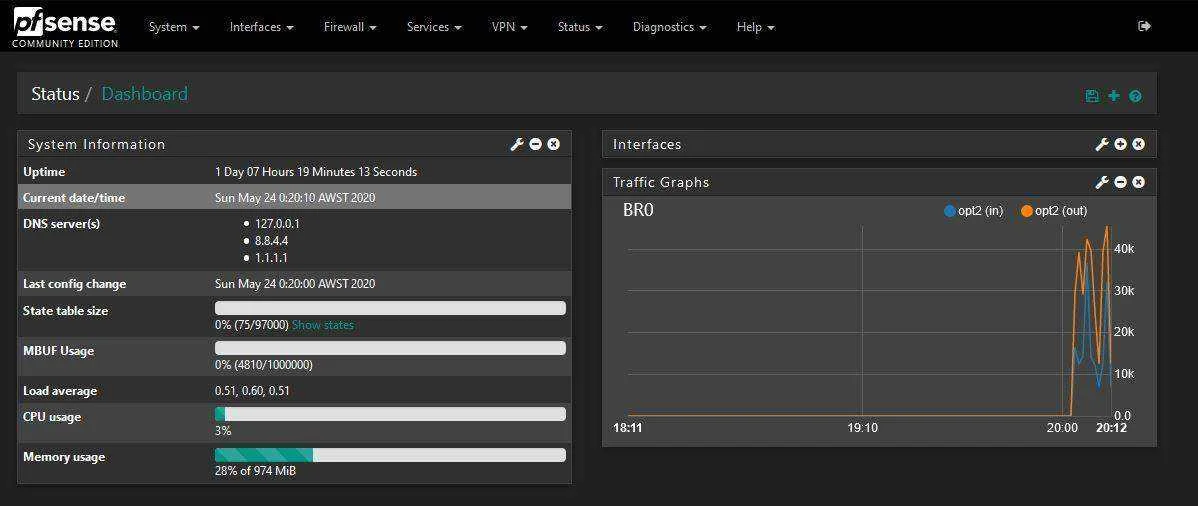

Tip ko sa mga gumagamit ng consumer grade na router, gawa nalang kayo ng barebone/virtual pfSense box. Current setup ko naka selective routing meaning all trafiic sa normal WAN gateway tapos pag Netflix sa VPN gateway naman (US) para mas maraming movie. Ready narin siya sa openvpn, squid and iba pang trix para network wide na di ung e-setup mo pa every device mo.

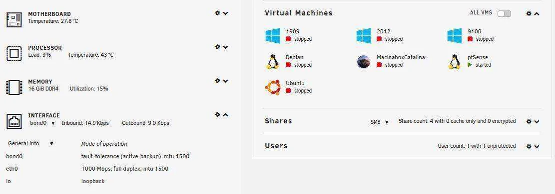

Bale router-in-a-box setup ko kasi virtualised si pfSense pero siya parin main router dito sa bahay. :)

  • Host machine is set to autoboot if power goes down. Also, it is using back up power (UPS). Network downtime is about 1min if for some reason backup power does not kick in.
  • For Type 1 hypervisors, upgrade frequency is too long to pose a problem. You also do not require upgrading server grade software unless it is almost to be EOL.
  • Host machine is serving other things like NAS, test/dev sites and other VMs. I do not need to power it off coz the main idea is to centralise the control of my network/apps/PCs/VMs.
