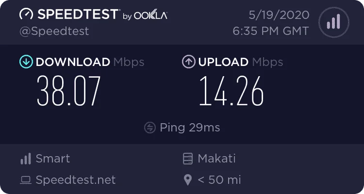

Sayang naman kasi yung potensyal ng modem na yan kung hindi mo i-maximize. 👇
Hi same rin nangyari sa akin using PLDT sim sa openline na modem... what I did is changed the IMEI of Modem to Smart IMEI. Search lng kau ng Smart PLDT na IMEI. In my case, ginamit ko lng yong IMEI ng SMART PLDT modem ko to my openline Huawei B315s-936.
PS. Dapat then open yong TELNET ng windows niyo.. Hope it will help
