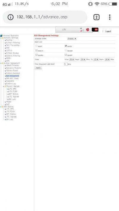

Pano po pag ganito ayaw ma tick ng band 1 at band 28?
Ito po router version ko
Device Model:Evoluzn FX-ID3
Router Version:Evoluzn_PLDT_ID3_1.1.0
Salamat
Yes po na ka chevk na siya sa 1 at 28 pero dashboard band 3 naka show
I had the same issue when I learned to set this frequency set-up manually. I believe it's your modem helping you still "get" signal from the tower due to its incapacity to receive a signal from Band 28.
What I did is, I took a very long extension cable, plugged in my modem, then placed my modem in every feasible corner where it can collect the signal.
Please note that I kept the frequencies locked to Bands 3 and 28 while scanning. By default, you will see Band 3 locked in the system. Then, after reaching RSRP of equal to or more than -100 AND SINR of over +5, keep it to where it's placed at that very moment, reboot your modem, and you should see the band change to Band 28 with better internet speed - at least this thing happened to me, may not be applicable to everyone.
