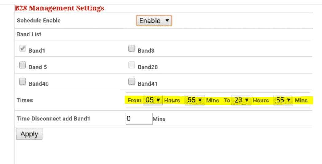

My goal when I made this set up was to always pick-up LTE band 1 as default.
When you set-up "Time Disconnect add Band 1" to Zero (0) and uncheck all other bands, it will automatically select Band 1.
In this photo, "Times" indicates the timeframe when Band 28 will get activated. In this case, it's between 11:30 pm - 5:55 am. And this only affects Band 28. All other open bands will not be selected unless you tick them.
Current firmware is Evoluzn_PLDT_ID3_1.1.0

I'd say you put a check mark on the weakest/non-existent LTE band in your area that is available in the selection. That way, when your modem cannot connect to the "Weak" LTE band, it will route to band 1. Let me know if that changes anything.

I wanted to update you with the results.
I have tried resetting my router and i did as what you told me.
Now I have band 1 selected.
You mentioned earlier that following the setup indicated on the image will let me select band 1 ( which i did thanks btw )
but my question is regarding what you said regarding band 28.
so you said that following the setup above, my modem will be connected to band 1 and by 11:30pm - 5:55 am my modem will switch me back to band 28, am I understanding this correctly?
Magic! :)
FX ID3 unfortunately doesn't want us to escape Band 28 the entire day. You can set it up like what's on the screenshot below. That way, Band 28 will only get activated between 11:55 pm - 12 midnight. You might ask if this can be set up for Band 28 to be activated at dawn, but it doesn't work that way. I tried. :( AND yes, you got it right!
Magic! :)
