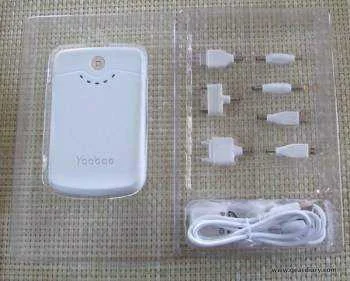

The better quality power banks will come with a set of connectors for different device types, such as, Sony Ericsson , Apple, Nokia, Samsung, etc.
