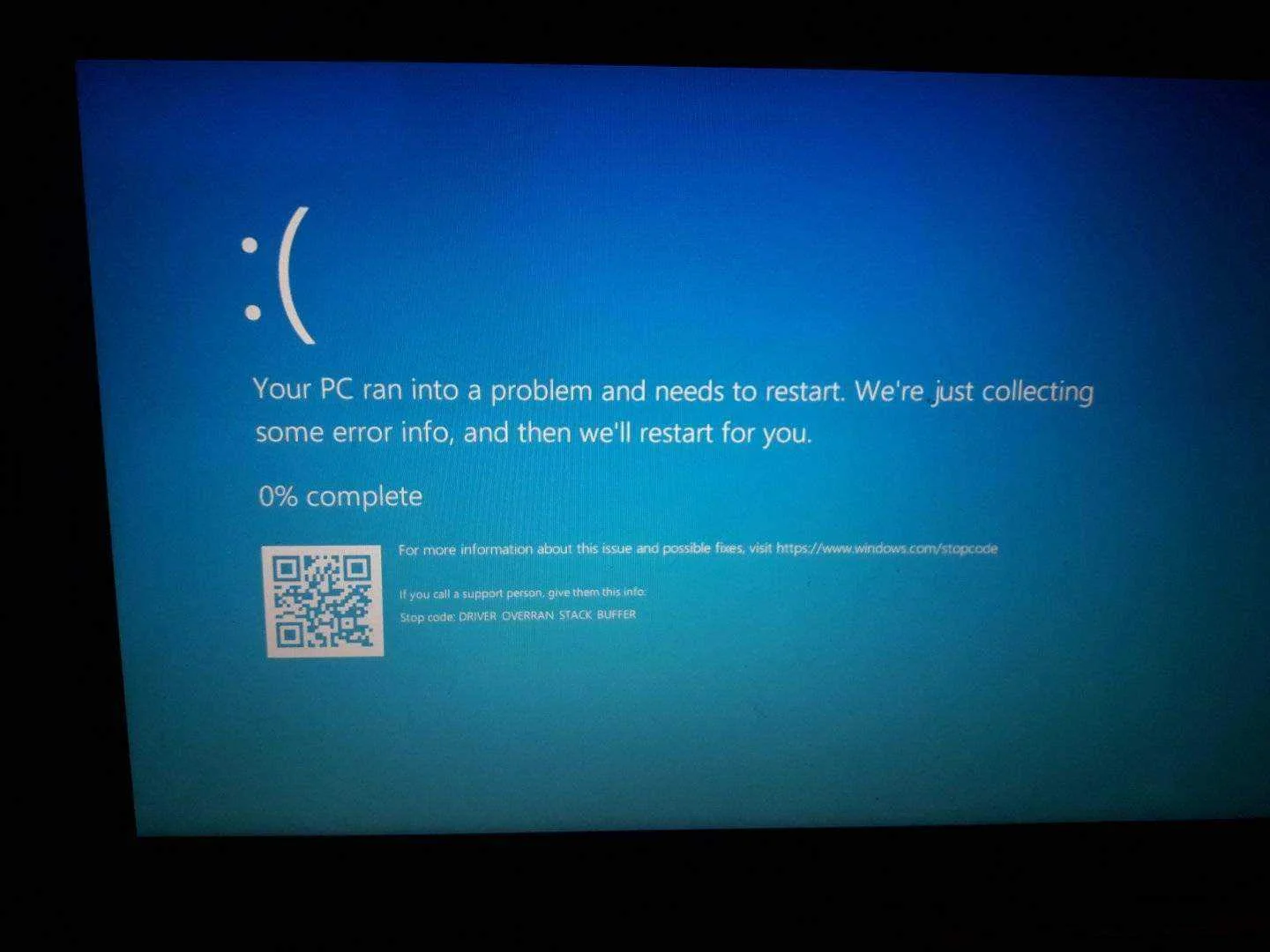

Help po sa may mga alam, After ko kasi i'update yung Windows 10 ko hanggang loading screen nalang siya then ni reset ko after that nawala yung OS :( Sino po may alam badly need a help kailangan ko kasi sa school thanks sa sasagot

May lumalabas po na blue screen tapos restart siya ng restart20200212_001528.webp
May lumalabas po na blue screen tapos restart siya ng restartView attachment 785370
The DRIVER OVERRAN STACK BUFFER might appear for various factors and here are some common items.
  • Overclock PC. Many Windows users prefer overclocking their computers to obtain the best performance, but this may cause many problems including the BSOD error we are talking about.
  • Certain system files. System files might also cause the problem. Sometimes you will get a window with error message showing the name of the file that causes the problem, rather than blue screen.
  • Peripheral that isn’t compatible with the current version of Windows 10. This factor can be checked easily by disconnecting all your external peripherals, especially USB flash drive and external hard drive.
pero tingin ko, may corrupted na system file sa OS mo, kya ganyan sya
na try mo na ba mag system restore?? try mo press F11 (pero depende ata sa board mo kung F11, try search sa google) bago mag boot yung computer mo tapos punta ka sa Advance Options > Troubleshoot > Advance Options > System Restore tapos follow steps mo na lang, mag basa ka na lang ng mabuti dun sa lalabas na GUI nya, try mo lang wala namang mawawala, ;)
Paps, start mo route sa start up repair if pwede ka maka punta sa CHOOSE AN OPTIONS. Doon maka reset ka at keep my files. Let me know if working, if hindi,, usb recovery image ka talaga.
