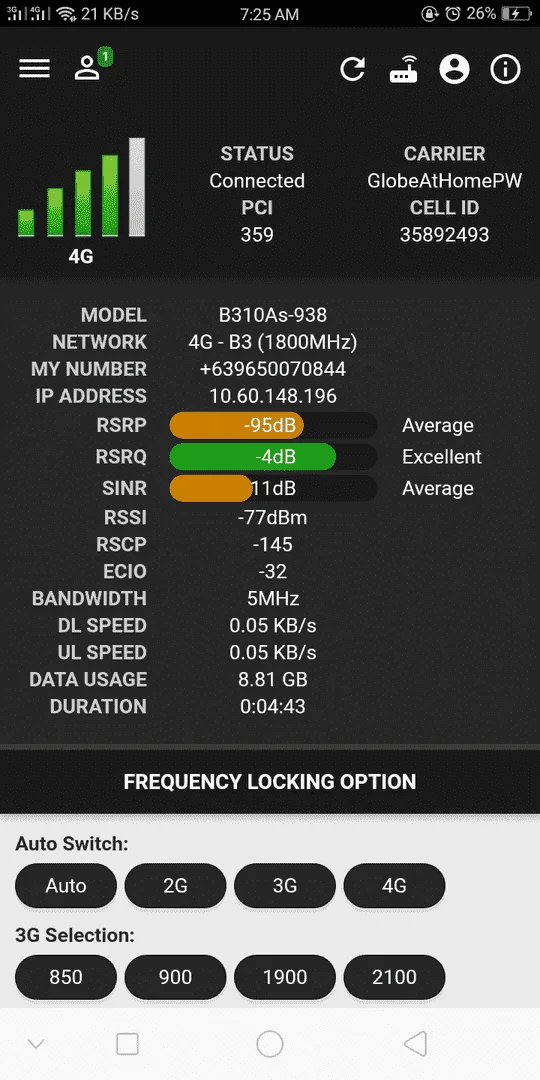

❓ Help About modem 938 signal strength
model: kung ano yung gamit mo na device
network: 4G, may signal kasi na 2G/3G/3.5G/4G/LTE, sa case mo 4G using the frequency 1800 MHz, depende kung ano ang assigned sa network
number: number nung sim na nakasalpak sa modem
ip address: unique address na assigned sa device kapag connected sa internet
rsrp: Reference Signal Receive Power, di ko alam kung ano to, pero base kay pareng google, average power of Resource Elements (RE) that carry cell specific Reference Signals (RS) over the entire bandwidth
rsrq: reference signal received quality, ayon kay wiki.telnotika,Reference Signals Received Power (RSRP) and Reference Signal Received Quality (RSRQ) are key measures of signal level and quality for modern LTE networks. In cellular networks, when a mobile device moves from cell to cell and performs cell selection/reselection and handover, it has to measure the signal strength/quality of the neighbor cells. In the procedure of handover, the LTE specification provides the flexibility of using RSRP, RSRQ, or both
sinr: signal-to-interference-plus-noise ratio , ito ba yung signal to noise ratio?, di ko na alam
rssi: Received Signal Strength Indicator, yan yung power na narereceive/nasasagap nd device mo galing sa access point or router
rscp: received signal code power, ito raw yan ayon kay pareng google denotes the power measured by a receiver on a particular physical communication channel
ECIO: ngayon ko lang nabasa to ah, EC/IO is a measure of the quality/cleanliness of the signal from the tower to the modem and indicates the signal-tonoise ratio (the ratio of the received/good energy to the interference/bad energy)
Bandwidth: 5 MHz, from the center frequency, may 2.5 MHz ka to the left and to the right, yan yung alloted na magagamit mo
DL/UL speed: bilis ng download at upload mo
data usage: gaano na kadami na consume mo
duration: up time ng iyong modem
frequency lock option: pwede 2G/3G/4G only... kapag auto, kung ano yung pinaka malakas na signal, dun magco connect ang modem
3g selection: yan yung mga frequency ng 3G
thanks pero yung gusto ku malaman bakit b3 1800mhz lang gumana sabi pareng google ito langbang worldwide... ok nmn mabilis speed nya pero gusto ku mawiden yung knowlegde ku about this type of matter para magamit sa future
