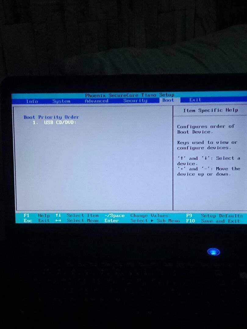

Sir ask ko lng po about FUJITSU AH531
na delete mismo ung DRIVER's pate window 7 ....nag try ako iformat kaso na delete sa booyloof ung usb pate mismo DRIVE D AND C huhu may way paba po para mabalil ung bootloof like usb IMG20200118235216.webp
