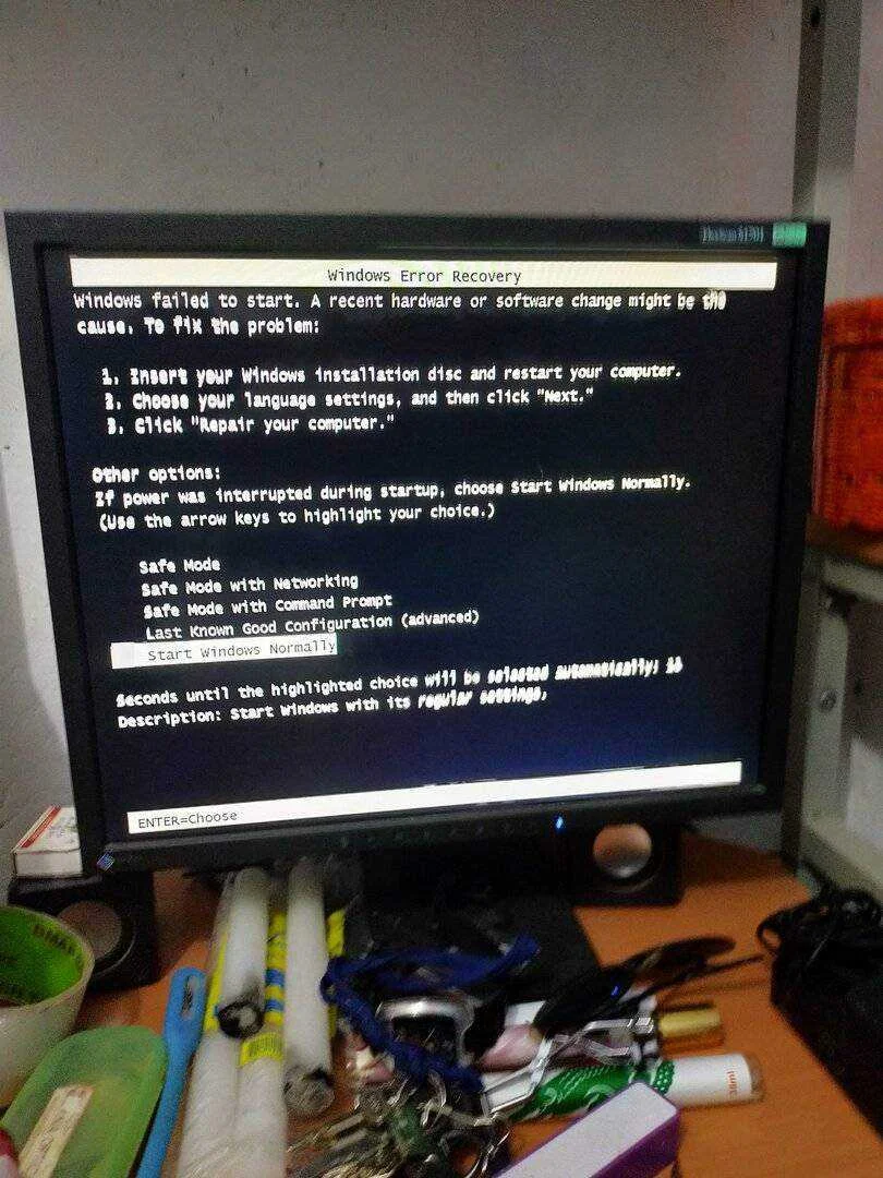

  1. Switch on the computer and tap F2 key to enter the BIOS.
  2. Once in BIOS, press F9 to load BIOS defaults.
  3. Press F10 to save and exit the BIOS.
  4. Tap F8 key repeatedly at Dell logo for windows "Advanced Boot Options".
  5. Use the up/down arrow keys to highlight “Last known good configuration “and press enter.
  6. If the computer does not boot to windows, restart and repeat Step 4.
  7. Use the up/down arrow keys to highlight "Repair your computer" and press enter.
  8. Select the input language and select your user account.
  9. Once at "System Recovery Options", click "Startup Repair".
