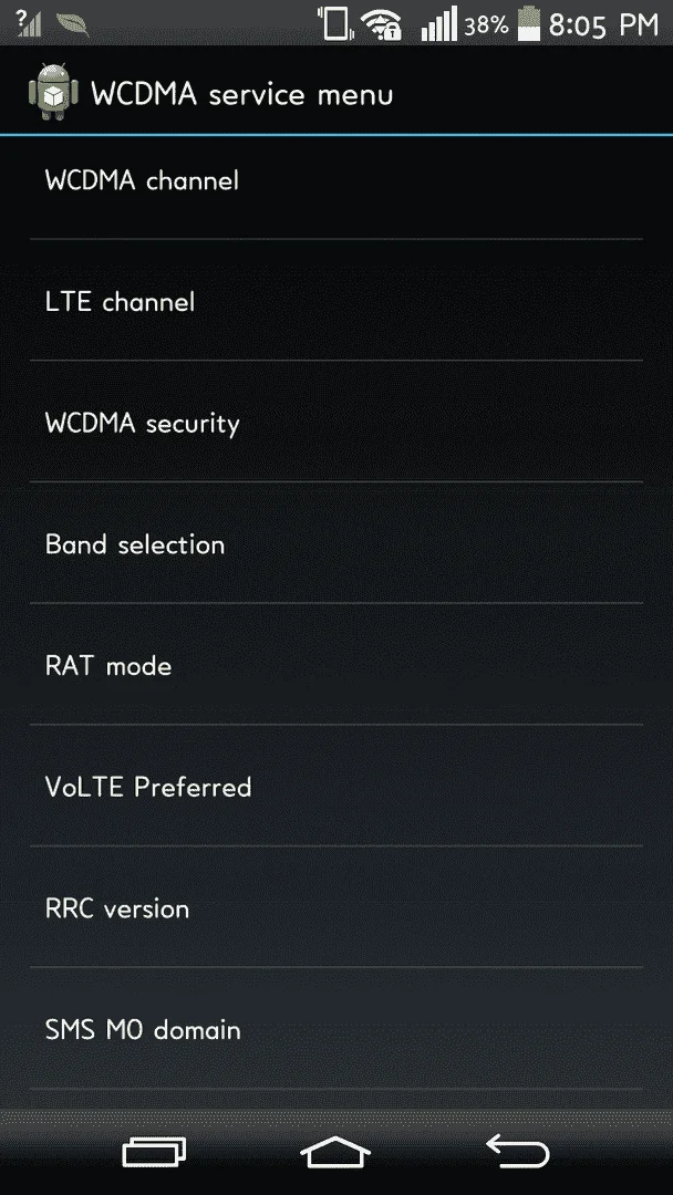

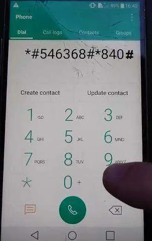

try kung may device test sa pagdial kagaya sa image pero imbes na 840 yung 520 na model number ng phone mo
field test>modem settings>rat selection>lte only
at try din 5457#*700#
LTE sim naman siguro gamit mo
naset nadin sa settings network>preferred network type to 2g/3g/4G/LTE
kamo upgraded nadin

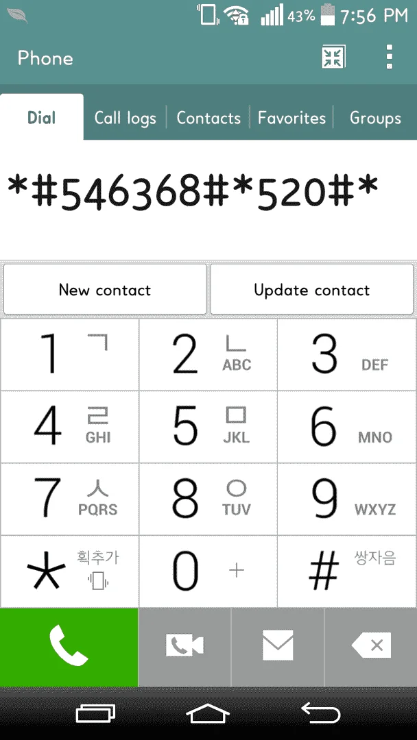

No effect paps

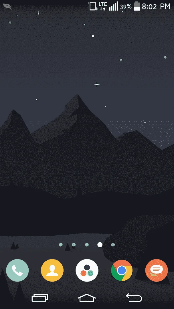

[QUOTE="reko-j, post: 14405079, member: 89009"] LTE sim naman siguro gamit mo naset nadin sa settings network>preferred network type to 2g/3g/4G/LTE kamo upgraded nadin try kung may device test sa pagdial kagaya sa image pero imbes na 840 yung [B]520[/B] na model number ng phone mo [B]field test>modem settings>rat selection>lte only[/B] at try din [B]5457#*700# [/B] [/QUOTE] Lte na paps maraming salamat ang tanong 4G naba ang signal strength nito?
