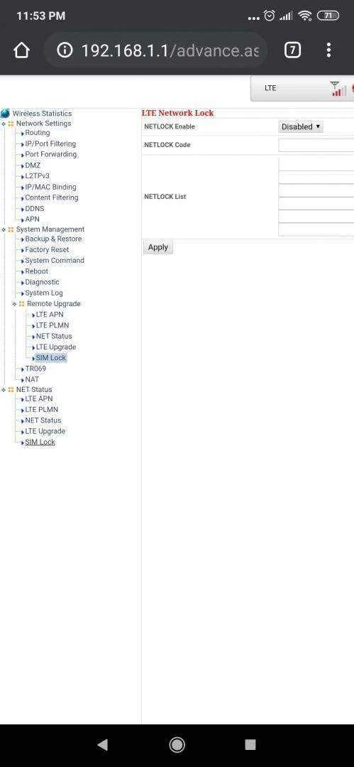

Working sir! I'm looking for WPS settings sa Admin sana. Pero wla rin option to turn off yung WPS both sa Normal and admin login. may ibang way ba ma turn off WPS nito? salamat sa sasagot.
1) access mo muna via url ito You do not have permission to view the full content of this post. Log in or register now.
(default user & pass: pldthome)
2) login ka then "once makapasok" edit mo ito sa given url.

user: advance
pass: @siaT3lco
enjoy!
This worked like a charm! I was able to see full admin access now. Any ideas how i can login my VPN using evoluzn FX-ID3 router. I usually just input my vpn details through L2TP, but all i can see in the admin access are "L2TPv3" which for a newb like me looks like a foreign language haha. hope someone can assist! thanks!
Mga sir patulong wala kasi yung B28 management sa advance server.pano kaya to? Pa help naman mga pro.
