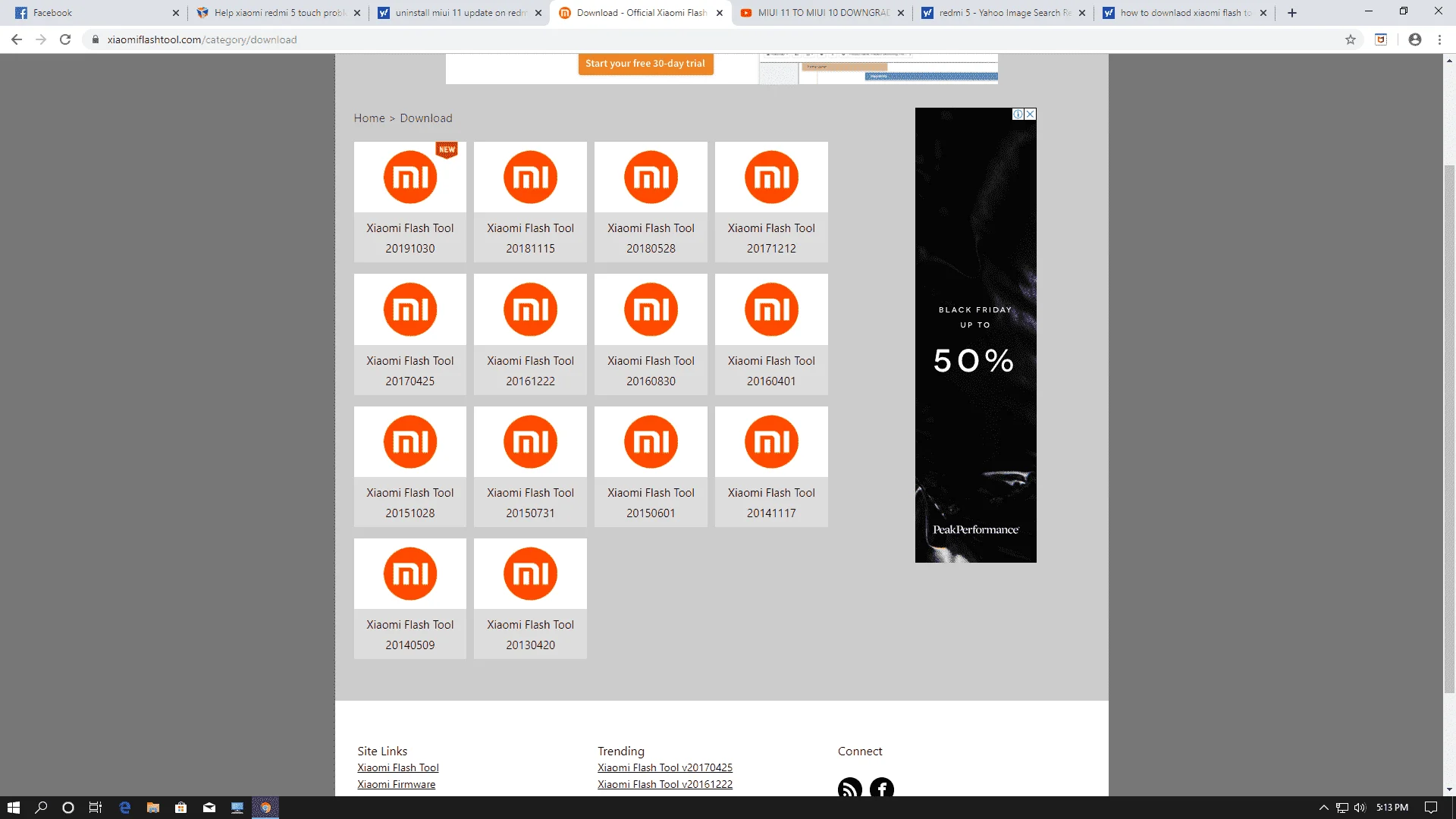

Unlock nba bootloader nyan or me twrp na nka installed?? Flash ka ng ibang custom kernel kung unlock bootloader at me twrp yan...pag wala downgrade kalang miui10 gamit xiaomi flash tool

Try mo i downgrade sa Miui10 via fastboot.
