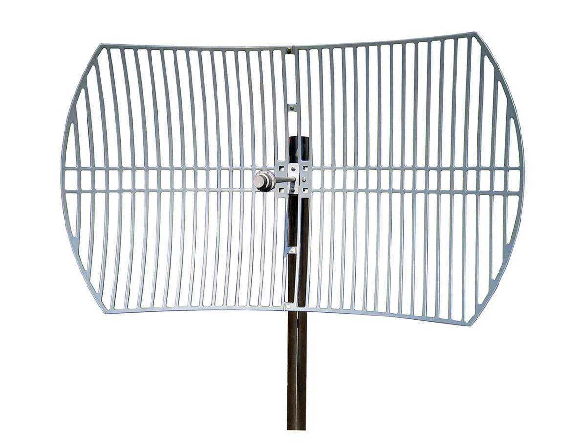

TL-ANT5830B.webp TL-ANT5830B.webpSpecification
Dimension
600×900(mm)
Frequency 5.15~5.85GHz
Impedance 50 Ohms
Gain 30dBi
VSWR(MAX.) ≤1.8
HPBW/H( °) 6
HPBW/V( °) 4
Polarization Vertical or Horizontal
Connector Type N Female
Mounting Pole Mount
Operating Temp. -40℃~60℃(-40℉~140℉)
Storage Temp. -40℃~60℃(-40℉~140℉)
F/B Ratio >30dB
Maximum Input Power 100W
Mounting Mast Diameter Ø30~Ø50 mm
Radome Material Aluminium Die Cast
Standards RoHS, WEEE
Survival Wind Speed 241Km/hr
Mga bossing tanong ko lang po pwede po ba to sa wimax natin?
yong gamit ko na frequency range 2.6 Ghz
baka may ma suggest po kayo sakin para mapalakas yong signal ng net ko
