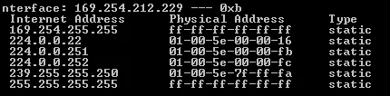

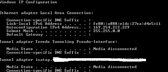

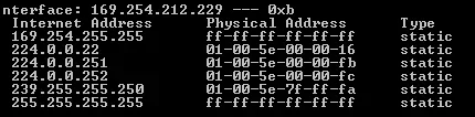

okay 169 ip ka, ibig sabihin corrupted firmware / wrong insertion of firmware :)
eto gawin mo :) Reflash ka sa Dv235t greenpacket firmware You do not have permission to view the full content of this post. Log in or register now. after succesful flashing binasa ng network adapter mo si firmware, re Flash ka ulit to BM622m 2012 Firmware You do not have permission to view the full content of this post. Log in or register now.
dapat mabasa ng network adapter mo si firmware,di dapat 169 ip :D

After this command at succesful mukang bago na ulit ang web gui mo,Master mac at default na ulit
*Note: Always Check arp -a on cmd yung Default Gateway 10.1.1.254 for dv firmware 192.168.254.1 for bm622m
*Keep in mind na dapat atleast mabasa ng network adapter mo si firmware,dapat di 169 ip,kung 169 ip parin. Reflash kalang ng reflash hanggang magkadefault gateway ka.
