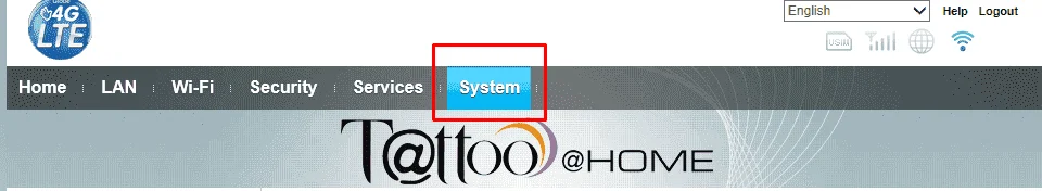

2. Click System
3.Go to Upload Configuration File
4. Browse your file
5. Click Submit

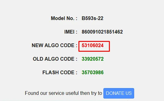

2.Copy your IMEI & Model of the router.
3.After copying the information given proceed to this site to type your IMEI & Model
Note: You should have a Google Account
4.Sign in with Google
5.Put your IMEI & Model
6.Click Calculate
7.To see the result click this G+
8. Here's the sample of the Result
9. Copy NEW ALGO CODE
