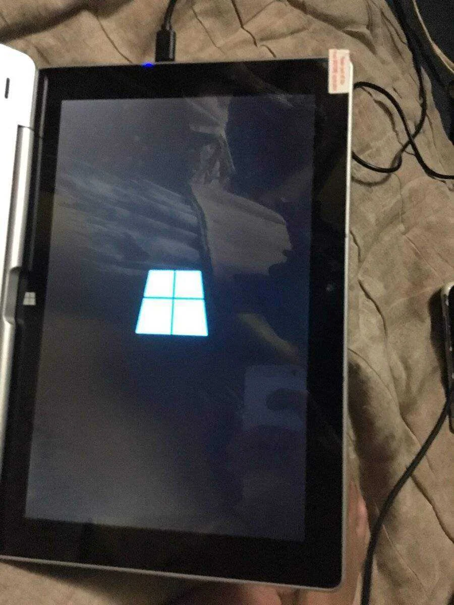

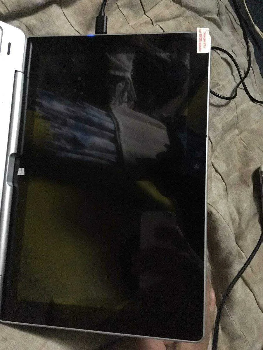

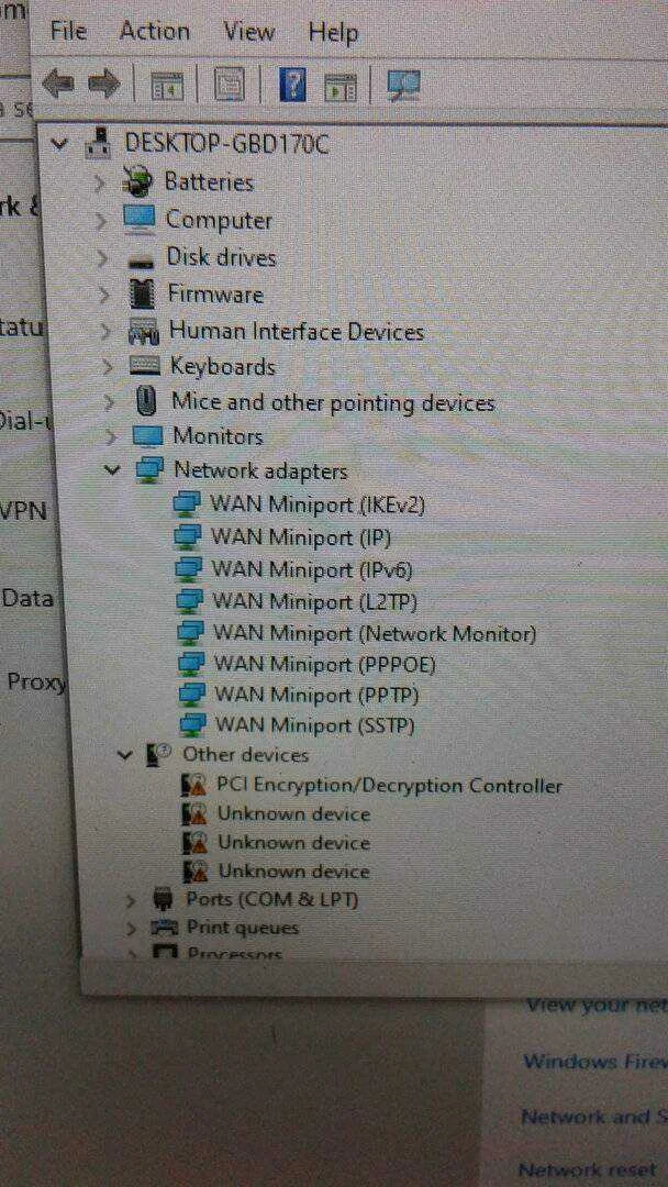

thanks a lot po sa inyo, okay na po siya, ininstallan ko na ng windows and it’s work, kaso nawala yung connectivity ng wifi, then ayaw na ma touch(windows tab. Po pala ito) after installing windows 10 ver1903
japan made laptop mo? hahah di ko masearch yung tamang driver
post mo dito yung ng HARDWARE ID nung apat na other devices.
papost dito nung apat na ganito mo
"PCI\VEN_14E4&DEV_4727&SUBSYS_7179144F&REV_01"
1. Go ka sa safe mode with networking
2. Run cmd as admin:
3. Run this command
DISM /Online /Cleanup-Image /RestoreHealth
4. Run this command
sfc /scannow
5. mag scan ka using anti-virus such as Adwcleaner
