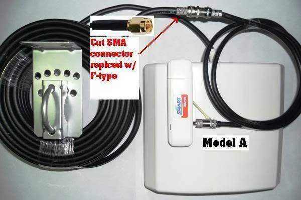

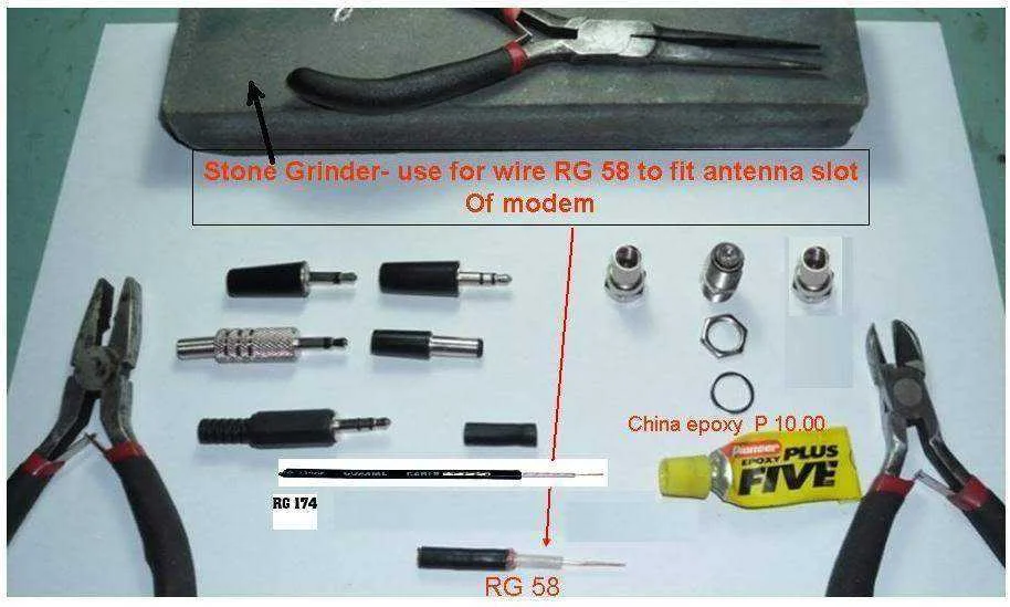

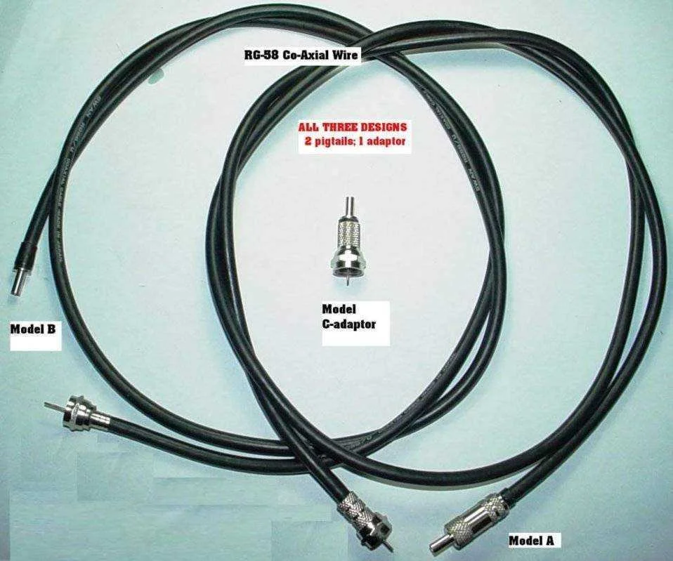

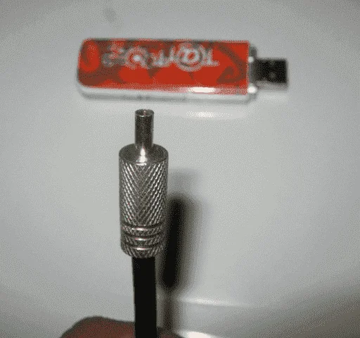

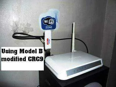

Build your own CRC9 for your Modem.
This crc9 is adapted to modems w/ crc9 external antenna slot for boosting signal strength.

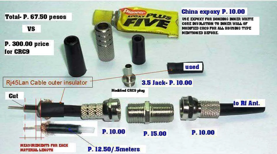

Budget: 40 pesos

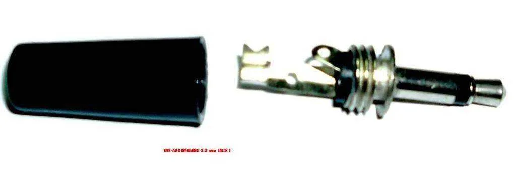

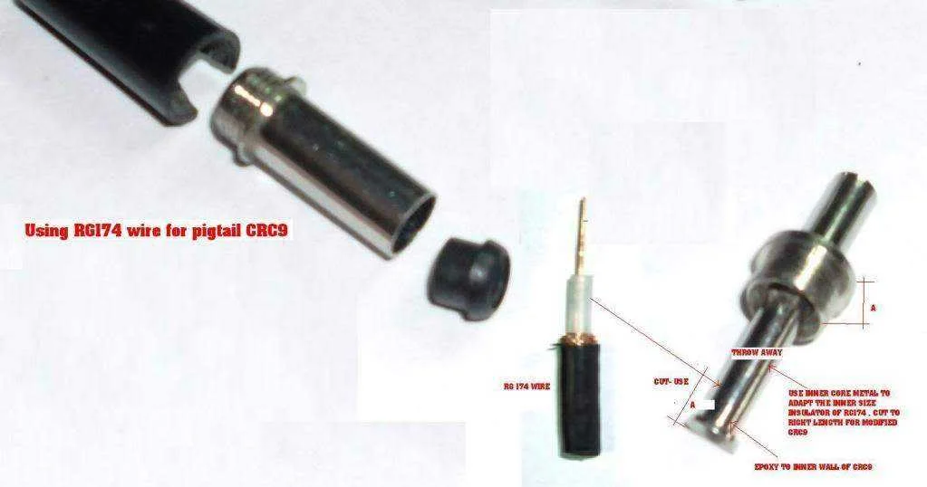

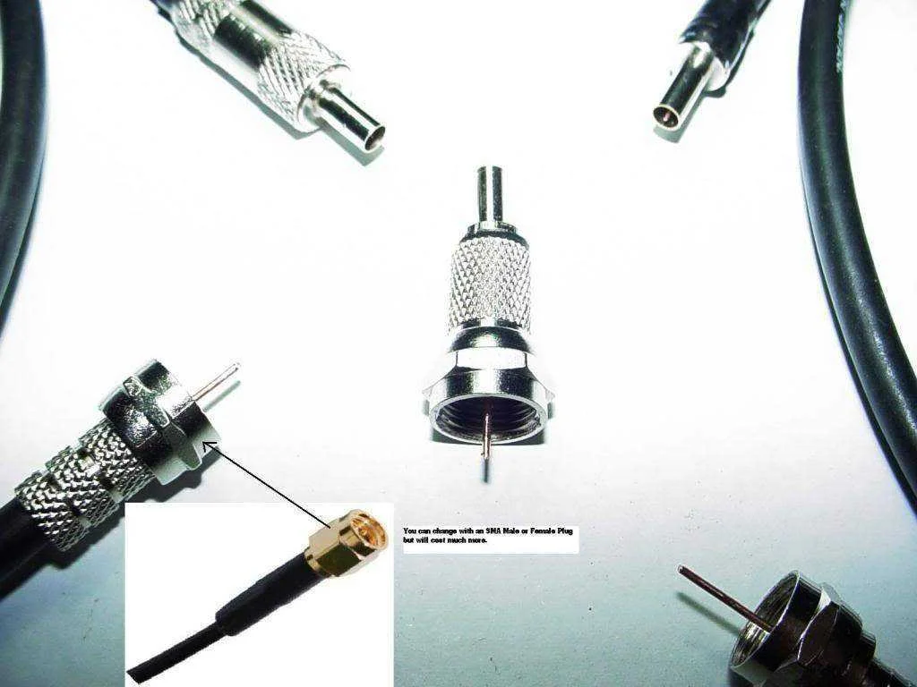

  • 2 pcs. baby mono plug (1 extra just in case)
  • 2 pcs. r-58 coaxial f-jack (not sure of name, 1 extra for replacement in coaxial cable from antenna)
  • 1 pcs straight connector ( not sure of name)
  • mighty bond
  • sand paper
  • 8 inches coaxial cable
  • 4K
