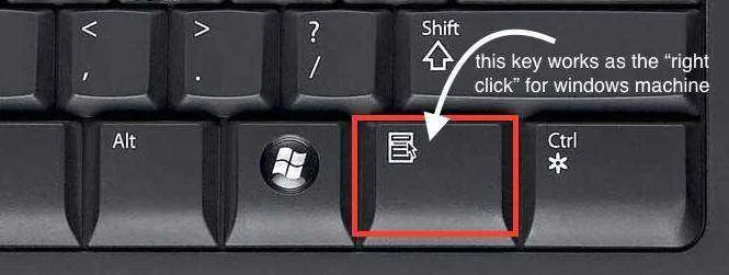

not sure sa malware, naisip ko lang baka sira yung touchpad physically kaya ung sinuggest ko is ioff.
OR baka pala napipindot/nakadiin ung keyboard shortcut na right click check mo din.
