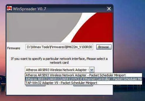

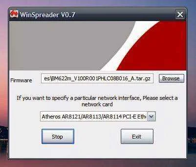

1.) Turn OFF your WiFi or unplug your networking cable from your PC
2.) Extract the You do not have permission to view the full content of this post. Log in or register now. on your desktop and double click WinSpreader.exe
3.) Locate the firmware which you have downloaded and select your LAN or Ethernet Adapter (gagamitin natin ay cable para iwas sira)
4.) Then click start.
5.) Plug a networking cable to your BM622m and plug it to your PC. (NOTE: MARAMI ANG NAGKAKAMALI DITO. DAPAT PO DI PA NAKASAKSAK ANG MODEM NYO SA ADAPTOR)
6.) Plug your power adaptor (YUN, EXCITED NA SI APO)
7.) You will see the signal led running an indication that the firmware is being burned to its board. (Wait for about 2 minutes to finish)
8.) Kapag 5 LED ang nag bi-blink, click STOP at hugutin ang power adaptor ulit.
9.) Mag login sa GUI 192.168.254.1 | user | 0SlO0510 > Restore Default (Mag re-restart ang modem mo)
Or just simply press the physical reset button of your wimax.
10.) BOOM, 2012 package na ang BM622m mo :) Congratz!
