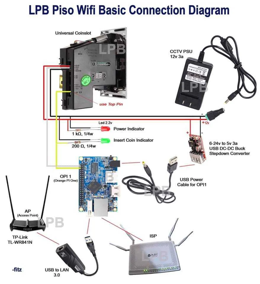

Cheapest Piso WiFi para sa lahat ng beginner.
Parts needed:
1. Orange Pi One (5V 3A supply)
2. Usb to Lan (gigabit)
3. Lan cables
4. 16gb sd card class 10
5. LPB license
6. Access Point
Voucher type po ito. Ibig sabihin mag generate ka ng voucher tapos yun bibilhin ni customer sa'yo para maka connect sila sa piso wifi mo.
LPB software (remove space sa google):
You do not have permission to view the full content of this post. Log in or register now. o o g l e.com/drive/mobile/folders/1vYCPkK2z-9HFF0EIn1o8L1xAuz7-Sqgv/1ox4jUuW-ho4ueBZIQpJnFAJKHhFoiVjo?sort=13&direction=a
Use etcher to flash the LPB software to the sd card.
More or less than 3k lang magastos dito depende sa AP na gagamitin mo.
See attached file as sample. Wag na lang pansinin magulong wiring ko. Hehe
Para naman sa mga gusto gawing fully automated, magdagdag lang ng 12V 3A na supply at coinslot. See attached diagram para sa wiring.
All credits to LPB.
