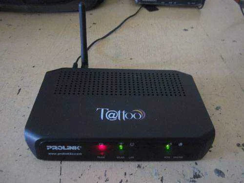

Prolink H5001N
Meron kabang ganito at wimax? tas di mo magamit sa wimax?
sayang naman paganahin natin....

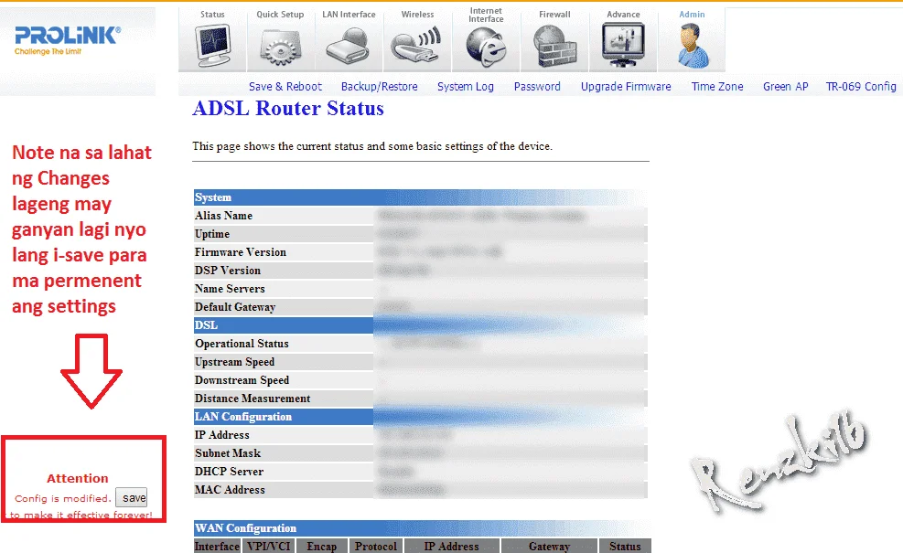

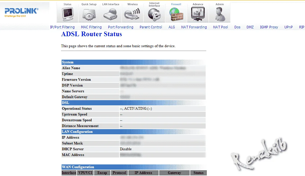

How to Log in (GUI)
type in the URL box: 192.168.254.254
username: user
password: user
just in case na di pa napapalitan yan ang default password at username.
then after mo mag log in eto lalabas (Note! in-upgrade ko na sya date may logo ng Globe yan)

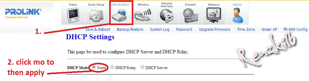

Then after nito punta ka sa LAN interface>DHCP Settings >then click none >apply
Ok nayan bale ang Wimax na ang magiging DHCP server...;););)

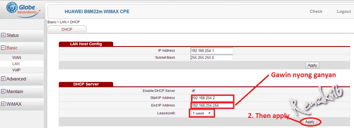

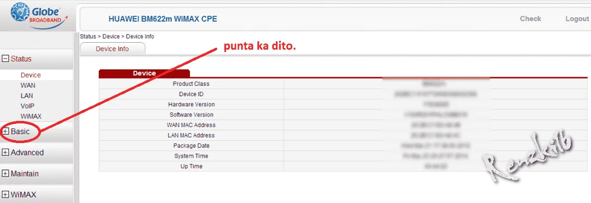

Next set up mo yung Wimax mo punta kasa 192.168.254.1 (in this case 22m gamit ko)
so pasok lang kayo gamit ang username at password ng yong device
kung iba device nyo dito how to log in (Bm622,22i,225 etc) :
Tutorial - ★ ★ ★ globe wimax complete tutorial ( h@ck1ng, tweaking etc etc... ) [updated]★ ★ ★
Then go to Basic>LAN then palaitan mo yung DHCP gayahin mo yung nasa Picture
OK na i-test mo na kung working...!(y)(y)(y)

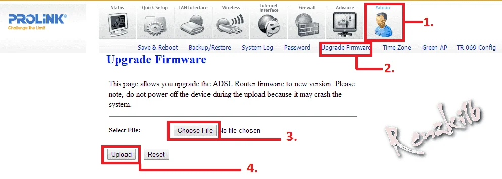

HOW to upgrade Firmware?
Just download the file:
then after nyo maidowload ang firmware punta ulit kayo sa 192.168.254.254 log in kayo then punta sa Admin>upgrade firmware>choose file>then hit upload then wait nyo until matapos magloading.

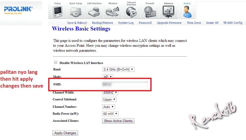

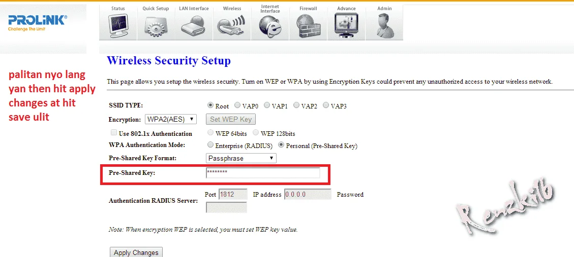

How to Change SSID at Wi-Fi password?
Note:
(Try at your own risk po! pero napagana ko naman)
