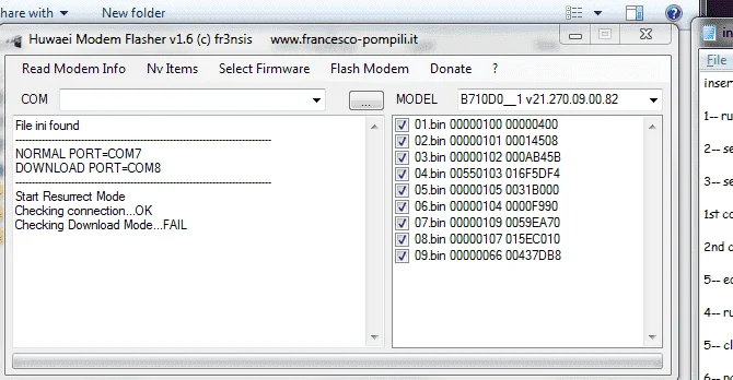

Hi sir! ito lagi lumalabas sinunod ko naman lahat ng steps. Pls help Thanks!

Hi sir! solve na problem ko dito. Yung mga naka encounter ng gantong error follow nyo lang to.
PLEASE NOTE THIS STEP, make sure the modem is OFF, at this stage we will make the modem enter the "FORCE DOWNLOAD" system by: Press and hold the POWER and MENU buttons simultaneously until the LCD screen appears "FORCE DOWNLOAD", if the LCD appears FORCE DOWNLOAD quickly press the MENU button, so at this stage after the FORCE DOWNLOAD appears immediately you press the menu button, If you successfully enter FORCE DOWNLOAD mode, an icon / image will appear on the LCD screen. UP ", if you have not made it into FORCE DOWNLOAD mode, turn off the modem and repeat step no. 4. At this stage it is most difficult because the FORCE DOWNLOAD text appears only a few seconds and you must quickly press the MENU button when the FORCE DOWNLOAD text appears.
or
run E5372Ts-601_Update_21.270.09.00.00.unlock4modem. mas mabilis para mag pumunta sa force download.
Kung kelangan nyo ng Huaweicalculator para sa Jailbreak code nyo pm nyo lang email nyo send ko sainyo.
