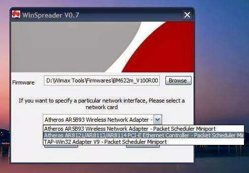

downgrade your BM622m 2013 to 2012 [SOLUTION]
his tutorial will teach you how to downgrage your Globe Huawei BM622m package 2013.
There are several reason why you need to downgrade your device.
1.) For you to change the mac address
2.) Package 2012 is supported by the You do not have permission to view the full content of this post. Log in or register now.
To start with, you will be needing these requirements:
1.)You do not have permission to view the full content of this post. Log in or register now.
2.) You do not have permission to view the full content of this post. Log in or register now. 2012 firmware for BM622m (LINK WAS FIXED)
Procedure:
1.) Turn OFF your WiFi or unplug your networking cable from your PC
2.) Extract the You do not have permission to view the full content of this post. Log in or register now. on your desktop and double click WinSpreader.exe

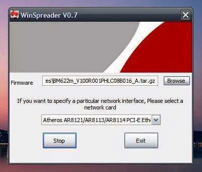

3.) Locate the firmware which you have dØwnlØaded and select your LAN or Ethernet Adapter (gagamitin natin ay cable para iwas sira)
4.) Then click start.
5.) Plug a networking cable to your BM622m and plug it to your PC. (NOTE: MARAMI ANG NAGKAKAMALI DITO. DAPAT PO DI PA NAKASAKSAK ANG MODEM NYO SA ADAPTOR)
6.) Plug your power adaptor (YUN, EXCITED NA SI APO)
7.) You will see the signal led running an indication that the firmware is being burned to its board. (Wait for about 2 minutes to finish)
8.) Kapag 5 LED ang nag bi-blink, click STOP at hugutin ang power adaptor ulit.
9.) Mag login sa GUI 192.168.254.1 | user |0SlO0510 > Restore Default (Mag re-restart ang modem mo)
Or just simply press the physical reset button of your wimax.
10.) BOOM, 2012 package na ang BM622m mo :) Congratz!
