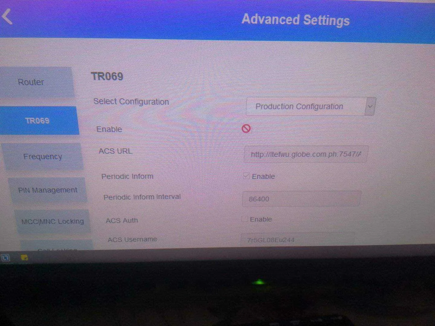

BAKA MAY NAKAKA ALAM KUNG PAANO PASUKIN ANG FULL ADMIN ACCESS NG GLOBIBO STREAMWATCH XTREME SA INYO? NA DISABLE KO NA YUNG MMC LOCKING NYA. NAGAGAMIT KO NA IBANG NETWORK. PERO NAKA MANUAL SET KASI APN NYA SA ATHOME.GLOBE. KAILANGAN SIGURO NG ADMIN ACCESS PARA MAPALITAN NG APN. AT GUSTO KO RIN SANA DISABLE TR069 NYA PARA IWAS REMOTE NI GLOBIBO ANG MODEM.

mag login muna kayo. 192.168.254.254 .tapos punta kayo device settings, > advance settings .tapos copy nio ung nasa search bar sa browser . EG. You do not have permission to view the full content of this post. Log in or register now.
tapos logout . makikita nio to sa search bar. (You do not have permission to view the full content of this post. Log in or register now.) palitan nio yan ng kinopy nio kanina. tas enter. antayin nio lang magloading. tapos login ulit. .punta na kayo ng device settings, >advance settings,. mag aappear na dun ung mga nakahide na settings like TR069, Frequency, at MCC/MNC locking. mag add lang kayo.. and mcc/mnc ng tm at globe ay 51502 ,51591, 51592. smart at TNT naman ay 51503. at yan ang iaadd nio.
sana makatulong.
Open line na. Salamat po. Di na kailangang bumili ng bago. Naglagay ako tnt sim. Sana smart bro sim para may data katulad Nung globe wifi promos.Pero dahil lockdown... Tiis muna sa normal LTE sim.

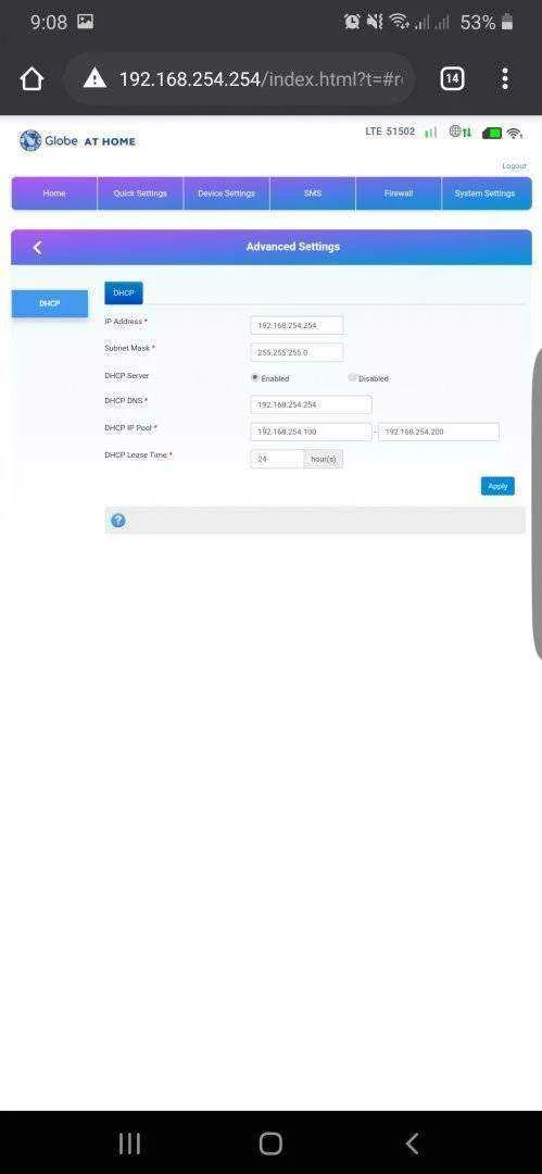

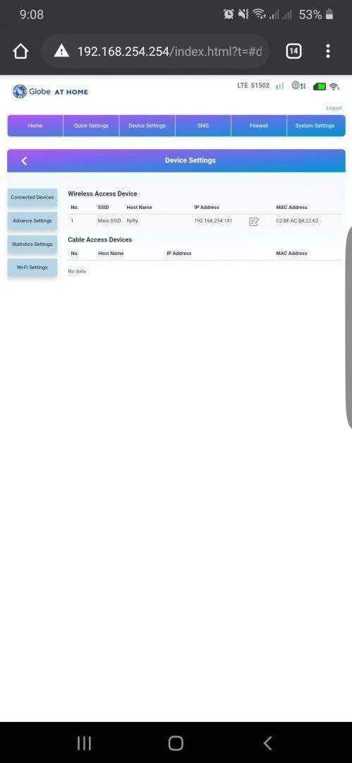

Pa help po ndi ko masundan kc parang iba na ung gui ng bago device eto napo ung bagong gui
