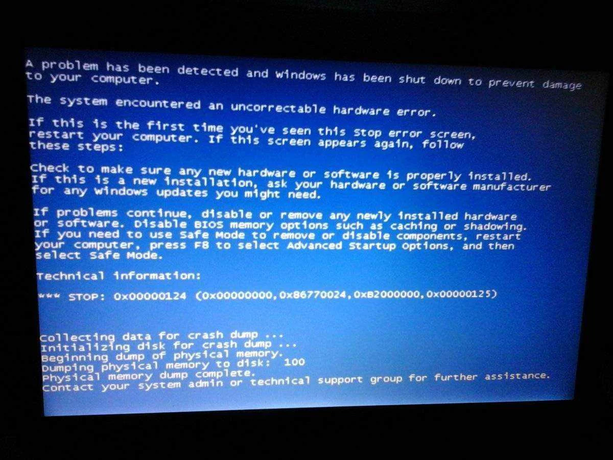

ka PH please help me! Yung memory at hard disk ko from my HP laptop tin-ransfer ko sa Toshiba Satellite L300D, kasi nga po na sira na yung LCD screen nya, mejo 5 years old na din HP ko... Since ang Toshiba ko working pa pero di ko na xa ginamit kasi may problem yung memory nya at walang hard disk...
So tinry ko i-transfer yung hard disk at memory, working naman xa, pero yun nga nag BSOD...
"The system has encountered an uncorrectable hardware error."
"Technical information:
****stop: 0x00000124
*note: attached is the picture for your reference ka PH
Yun yung lumalabas na error... marami na akong na try pero lumalabas sya once in a while... kanina nga habang ginagawa ko 'to, nag BSOD ulit... Di ko lang sure kung hindi compatible yung memory ko at hard disk ko dito sa laptop or yung drivers hindi compatible since HP drivers yung andito kasi nga from HP to na memory and Hard disk, at wala ko sya pang toshiba na drivers...
Guys please help, di ko tlaga xa ma solve yung issue kung ako lng, last resort ko yung clean install ng windows 7... Hope someone can give me an advice.. thanks in advance po...

PM me brad for pc and loptop hardware and software , troubleshooting.. imba TECH! ill teach you how to solve that problem without reformatting.. regedit lang yan brad.. that is not a hardware problem.. ung basic drivers lang yan sa dati mong laptop.. ung nagreply jan.. mali yan..
ito gawin mo..
1. ibalik mo ung hardrive at memory mo sa dati mong laptop
2. ipa.run mo.. sira ka mo ung lcd. eprojector or connect sa monitor..
3. punta ka REGEDIT
4. HKEY_CURRENT_CONFIG > SYSTEM > CURRENTCONTROLSET > ENUM
5. delete mo lahat ng laman ng ENUM
6. tas shutdown..
7. if bluescreen pa rin, baka iba ung processor ng dati at new laptop.. from intel to amd
8. go to REGEDIT uli
9. HKEY_LOCAL_MACHINE\SYSTEM\ControlSet001\Services\Intelppm
10. sa right plane modify mo ung START set value to 4.
11. shutdown..
12. transfer na ung hardrive at memory sa new laptop..
13. ok na yan!
hala boss jess baticula, ngayon ko lang po nabasa yung post nyo... mejo nakakairita kasi eh, kasi pag-open ko palang di ba nagboot sa windows shutdown na agad, tapos start-up repair pa, tapos nun mag blue screen pa... hehehe... cge boss try ko po to, gagawin ko nlng external monitor yung monitor sa office... hehehe... salamat po sa advice... i'll get back to you sir if nag work xa... salamat po ulit ang more power po...
