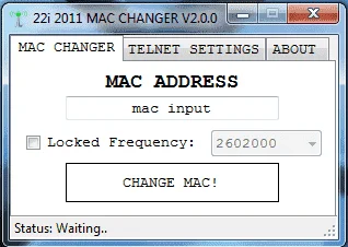

  • bm622i 2011 Mac Changer​
  • WIMAX​
  • bm622i 2011 Mac Changer V2.0.0​
  • SCREENSHOT​
  • 2011-1.webp​
  • 2011-2.webp​
  • REQUIREMENT:​
  • .NET FRAMEWORK 4.0 DOWNLOAD IT You do not have permission to view the full content of this post. Log in or register now.​
  • VERSION 1.0.0​
  • Mac Changer - madaling pag palit ng MAC..​

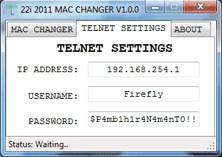

  • Telnet Settings - Dito nyo ilalagay ung IP, Username at Password ng telnet nyo.​
  • Auto Save ang mac, kaya makikita nyo pag binuksan nyo kung ano ung huling mac na ginamit nyo.​
  • Nag hihide din ung Firmware Upgrader..​
  • VERSION 2.0.0​
  • Locked Frequency added - pillin nyo ung pinaka stable na frequency nyo.​
  • Next Update:​
  • Subukan ko gumawa ng Mac Tester​
  • NOTE:​
  • Kailangan naka Direct yung modem sa Desktop/Laptop nyo, ndi pwedeng dumaan sa router, kasi mag eerror yan..​
  • Kailangan i Run As Adminstrator nyo ung program. or para mas madali at hindi nyo na ulit ulitin i run as adminstrator ito ang gawin nyo. Right Click nyo ung "bm622i 2011 Mac Changer", tapos click "Properties", then click ung "Compatibulity", sa "Previlige Level", check nyo ung "Run this program as adminstrator", then click "OK".​
  • Hindi nyo na po kailangan i run pa ung Upgrader, dahil kusa nyang i Rurun ung Upgrader.​
  • DOWNLOAD LINK:​
  • You do not have permission to view the full content of this post. Log in or register now.​
  • PASSWORD:​
  • pw.webp​
  • HAVE FUN!​
  • DON'T FORGET TO SHARE THIS, THANKS!​

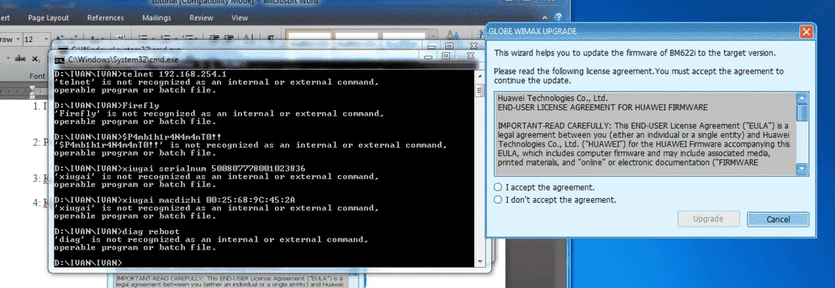

boss pede patulong para makapag open ako ng telnet hindi kasi ako maka access sa cmd to telnet pero nakakapag palit na ko ng mac pero hindi padin nagkoconnect eh... pa tulong po salamat godbless
yan po yung lumalabas pag magtatry ako pumasok o mag open ng telnet patulong po salamat
View attachment 12990View attachment 12990
Bossing mali mali yung ginawa mo. Ganito po ang tamang procedure:
ENABLE MO MUNA NATIN SI TELNET SA PC MO:
Kung Win7 ang PC mo, Go to Control Panel > click Programs > Turn Windows features on or off > Pag lumabas na yung laman nya, find the Telnet Client and Telnet Server. Icheck mo yun then Apply, OK. Wait mo lang at kusang mag-eexit yan.
Ayan naka-enable na si Telnet, pwede ka na mag-change Mac!
Step 1: Open mo muna yang Globe Wimax Upgrade
Step 2: Open mo yung command prompt na yan tapos type mo muna "telnet" (w/out qoute)
Lalabas dyan ganito:
Welcome to Microsoft Telnet Client
Escape Character is 'CTRL+J'
Microsoft Telnet > _
Step 3: Eto na ang simula, ang itatype mo dyan ay "open 192.168.254.1" (w/out qoute). Wait mo lang.
Step 4: Ayan nasa ATP Client ka na, type mo 'to sa:
Login: Firefly
Password: $P4mb1h1r4N4m4nT0!! (di mo makikita ang password kasi nga pambihira nga naman talaga) (copy paste mo na lang para sure na papasok)
ATP > xiugai macdizhi XX:XX:XX:XX:XX:XX (ang ilalagay mo dyan sa XX na yan ay yun working mac address mo) (wait mo lang at iseset na nito ang working mac address na inilagay mo)
ATP > diag reboot
(wait mo lang mag-reboot at ayan na!) Goodluck bossing!
