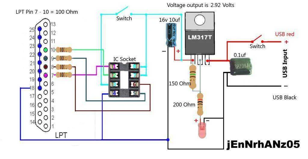

Resistor = 4x100ohms 1/2watts or ¼
Resistor = 1x150ohms 1/2watts or ¼
Resistor = 1x200ohms 1/2watts or ¼
LED = 1x color red 3volts
Capacitor = 1x 10uF 16 volts
Capacitor = 1x 0.1uF
LM317T = 1x 3voltage regulator
Socket IC = 1x 8pins SOIC / Socket IC
LPT Cable = 1x
Switch = 1x push switch 1x slide switch0.3mm diameter
USB Cable
PCV
0.3mm diameter
You do not have permission to view the full content of this post. Log in or register now. <-------------ito yung diagram!
