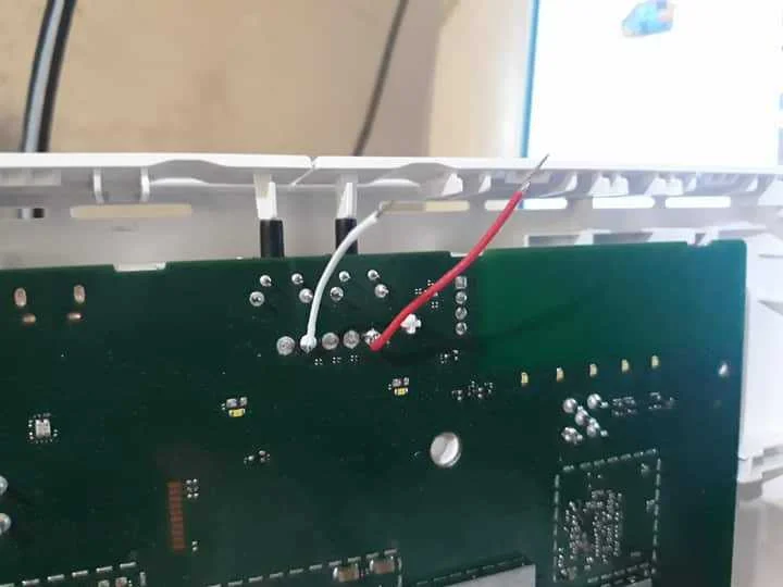

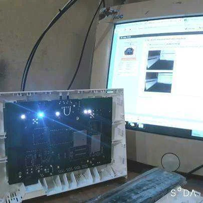

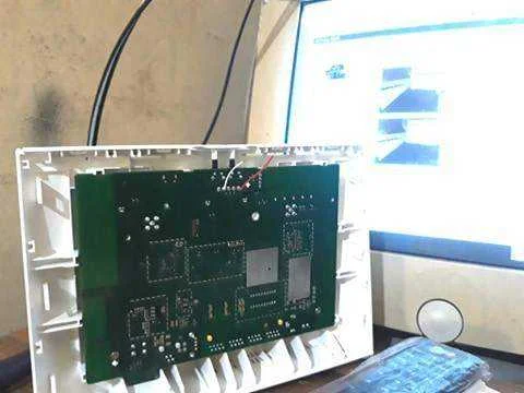

meron po kayo solution sa b525s-65a stock po sa USB mode, kahit walang jumper. NO BOOT, NO POWER, NO LED after ako mag flash ng firmware nato, dead boot nsya kahit magbayad po ako..
same tayu ng nangyare paps
stock sa usb boot kahit walang jumper
issue: * NO power
  • 1st attempt openline/debranding succesful tested sun sim pero no signal sa globe
  • 2nd attempt debranding ulit kasi hindi ako satisfy kaya kahit ano nagamit ko firmware ayon hindi na nagpower
  • 3rd attempt sa dami ko firmware nagamit hindi ko na tanda kng alin ko nagamit ayon nagka power at missing naman imei wala signal sun/globe
  • 4th flashing succesful pero nag ooff modem at hind na nag bo-boot at hindi rin nag green light, kahit anong firmware ganun pa rin.
naghinang po ako nitong wire na eto credits ky romeo621 ng kabilang forum at sa firmware mo po sir jhowel22 ( B525s-65a Huawei RELOADED Final 2019 )
1. jumper point usb mode
2. balong
3. debranding habang nag papaprocess cya bago matapos ang proseso dapat dugtungin ang wire para pag katapos ng flashing ay mag gegreen at magrereboot ang modem

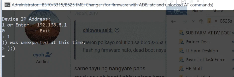

4. salamat din sa code ni sir "jerome" try ko ginamit ung code sa B310AS
tinry ko rin itong mga code at pumasok naman using telnet
atc AT^SN=KSD7S19911016667
atc AT^PHYNUM=MAC,E4FDA198A525,0
atc AT^SSID=0,"B310-8A526"
atc AT^SSID=1,"B310-8A526-1"
atc AT^SSID=2,"B310-8A526-2"
atc AT^SSID=3,"B310-8A526-3"
atc AT^WIKEY=0,"YBTG3537NFG"
atc AT^WIKEY=1,"YBTG3537NFG"
atc AT^WIKEY=2,"YBTG3537NFG"
atc AT^WIKEY=3,"YBTG3537NFG"
atc AT^RESET
4. Nvram writer at B525s-65a IMEI Changer

issue: * NO power
basabasa ako dito hehe nakakuha din idea
naghinang po ako nitong wire na eto credits ky romeo621 at sa firmware ni sir jhowel22 ( B525s-65a Huawei RELOADED Final 2019 )
2. balong
atc AT^RESET
[IMG alt="Click image for larger version.
Name: 92630767_2561276324191046_7055871814030852096_n.jpg Views: 4 Size: 21.8 KB ID: 1304823"]https://www.phc.onl/#forbidden#/attachment.php?attachmentid=1304823&d=1586218583&thumb=1[/IMG]
Name: 92428358_170025210765738_9048596941268582400_n.jpg Views: 3 Size: 38.9 KB ID: 1304824"]https://www.phc.onl/#forbidden#/attachment.php?attachmentid=1304824&d=1586223317&thumb=1[/IMG]
Name: 92579259_702575033829522_4859716952387485696_n.jpg Views: 3 Size: 36.7 KB ID: 1304825"]https://www.phc.onl/#forbidden#/attachment.php?attachmentid=1304825&d=1586223331&thumb=1[/IMG] yan na sya ngyon gumagana na
