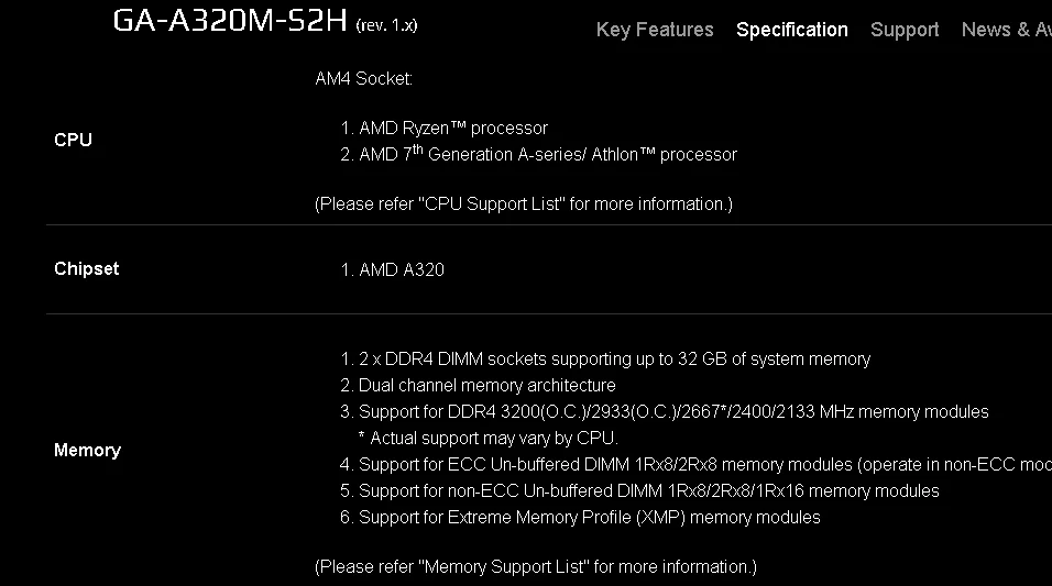

Ito specs ng motherboard mo,
dito check mo kung anong version ng bios meron ka
-> www,gigabyte,com/Motherboard/GA-A320M-S2H-rev-1x#support-dl-bios
Check mo dito sa list nila kung supported ung RAM na gamit mo
-> www,gigabyte,com/Motherboard/GA-A320M-S2H-rev-1x#support-doc

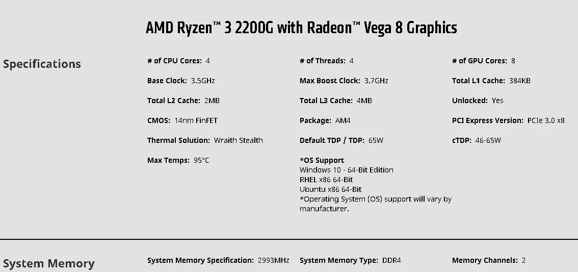

Max ram frequency supported ni Ryzen 3 2200g is 2993mhz
