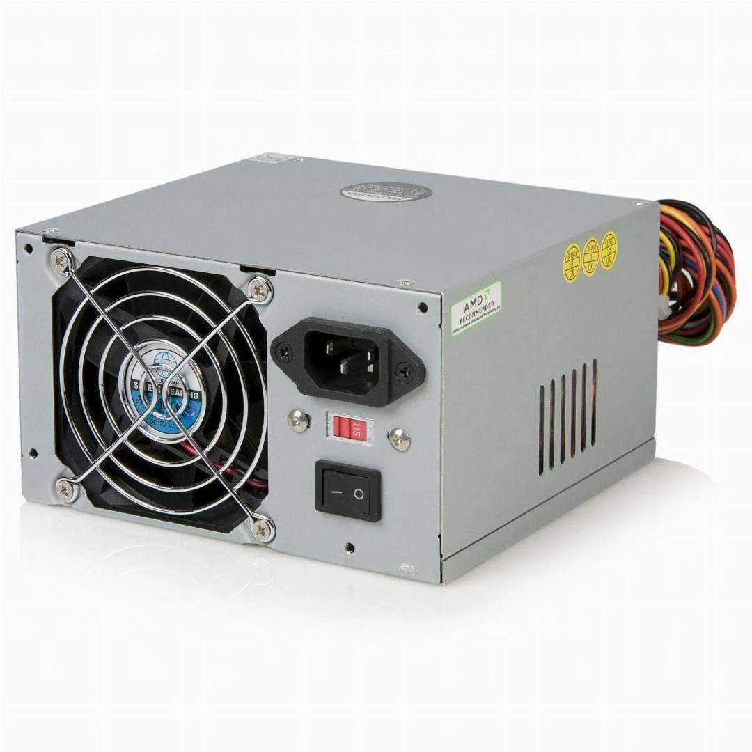

Yes kung Ryzen swak na swak dian yung 1050ti. Yep dapat yung di na need ng 6 pin. Tama din na palitan mo yung psu mo ng Tru Rated para sure ka na di nalang biglang puputok yung generic na psu mo.

invest mo muna sir yung pera mo sa Power supply. then upgrade ka na ng VC. dont settle your PSU with KOREAN PSU/ TRUE RATED. Go for 80% PSU. reliable tsaka di ka mag woworry na masira yung components ng System unit mo sir.

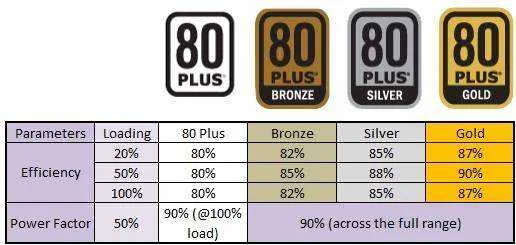

does it matter ba kung 80 plus bronze silver or titanium? basta ba 80 plus ok na?
