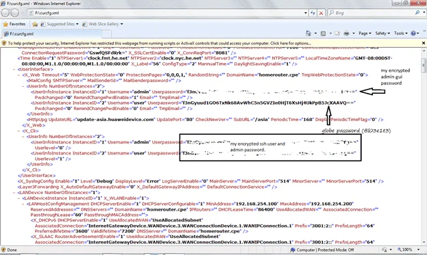

2. Since ang kukunin niyo lang ay admin password ng gui, I open niyo ang file na curcfg.xml (nasa loob ng app folder) dahil nandito yung encrypted password ng ssh at webgui. At dapat ganito ang inyong makikita:
3. Sa tut na ito, sa halip na admin password ang idedecrypt, yung user na password (l03e1t3) lang ang idedecrypt ko. Kung baga ipapakita ko lang dito sa tut kung pano yung f3nGyuud1GO6TxNk68AvWhC5n5GVZIe0HjT6XsHj4UkPpB5JcXAAVQ== na encrypted characters ay nagiging l03e1t3. Yung sa admin, kunin nyo lang yung may mahabang encrypted characters ng admin password niyo at gayahin lang tong procedures.

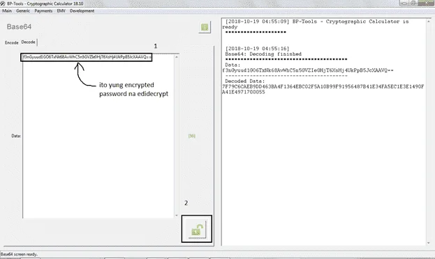

6. Yung encrypted na password is naka base64 at dapat munang nka hexadecimal. Click “Generic” menu, select Base64, and click “decode tab”. Ilagay yung encrypted password sa loob ng data box.
7. Click ulit “Generic “ menu, click DES, algorithm: 3DES, mode: CBC, data input: hexadecimal. Padding : none, Key: 3E4F5612EF64305955D543B0AE3508807968905960C44D37, IV: 8049E91025A6B548, data: (decoded data from step 6).

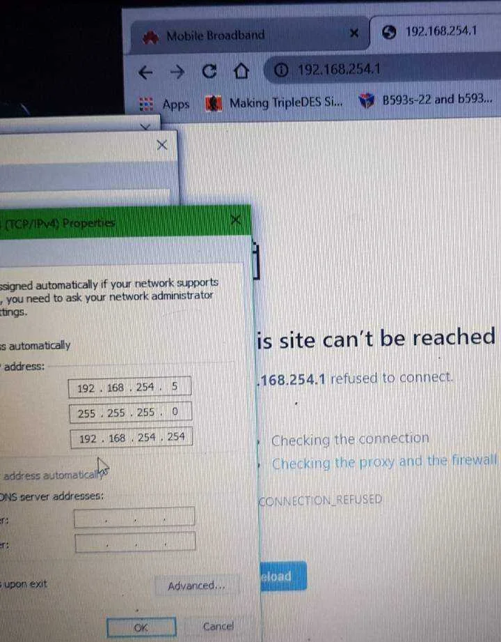

Pa help po.. ayaw gumana ng static ip po.. i tried Lready ung 192.168.254.1. At 5.. ayaw parin
Try mo muna i default yung network setting boss. Open cmd then type ipconfig /all, then enter. Screenshot mo yung output nung cmd.
1. Reset mo siguro muna modem mo boss.
2. Try mo muna i default yung network setting boss.
3.make sure connected sa pc yung modem via lan. Open cmd then type ipconfig /all, then enter. Screenshot mo yung output nung cmd.
