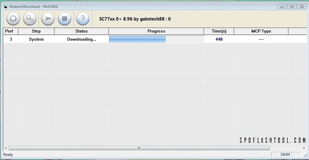

Open RD tool & Load Pac file
Click start Button, press volume up then Connect usb cable
Midyo matagal-tagal ang flashing nito wag mainip

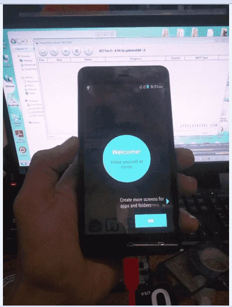

Just Wait Until Success!

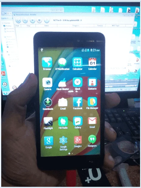

Done!
