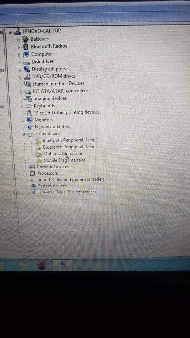

11. Insert the battery and other telecom sim card (preferably SMART sim to check whether the unlocking is successful). Don’t connect yet to the device’s wi-fi because it might still have connectivity issues due to incorrect IMEI, MAC and S/N Configuration between the firmware and the hardware.
12. Turn on your device and hook it up to your PC using your USB Cable.
13. Run your Device Manager on your PC (Windows)
14. Extract “20121130_V5_LTE_MIFI_Generic_Driver.rar”.
15. Update the driver of “Mobile AT Interface” and “Mobile AT Diag” by browsing the driver files which you have extracted.
