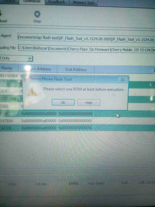

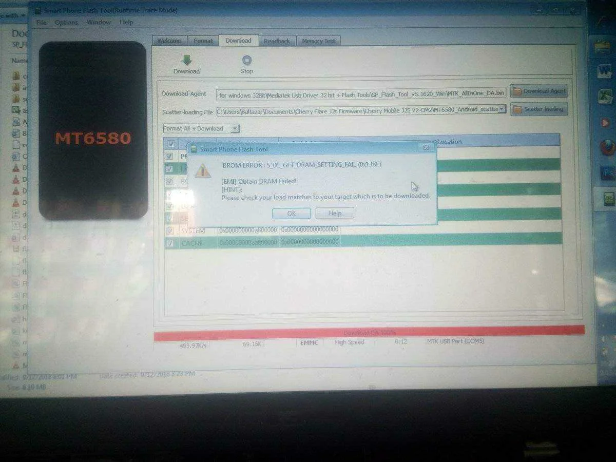

good morning guys plznaman ou pa sagot naman po sa problem ko plzzz wala naman pong nag reply sa mgapost ko plz mga kapatid pansininniyo naman ako....:):) ito po yong problema mo bakit ayaw mag start yong flash lahat ng firmware ni try ko na ayaw parin eh...

ano po pla history, bkit mo e faflash? ano sira
kasi Kapag e one ko siya ok naman Pero magHomescreen siya Mag Vibrate Na naka on pero kung gamitin ko mawala yong vibrate kapag elock ko lang mag vibrate siya tapos Ni try kung mag Flash Ayan sira na tuloy hindi na mag On kasi errorang pag flash ko ano pala kulang nito oi pagod naako plz patulung paps... .....:)
Error: Please select one ROM at least before execution
Meaning: SP Flash Tool fails to recognize that there is an item ticked.
Solution:
  1. Select the Scatter file again and untick all the items which you don’t want to flash one by one. Don’t use the check box which un-ticks all the items at once and then checking one by one.
Solution:
anong dapat gamitin ko ma flash tool momshy yong MTK flash tool V5?
dapat factory reset na lang ginawa mo sir..
flashing lang po yan, baka hindi mo makapa, or try mo e flash sa nck crack.. dun, hindi na kinakapa bootkey niya..
