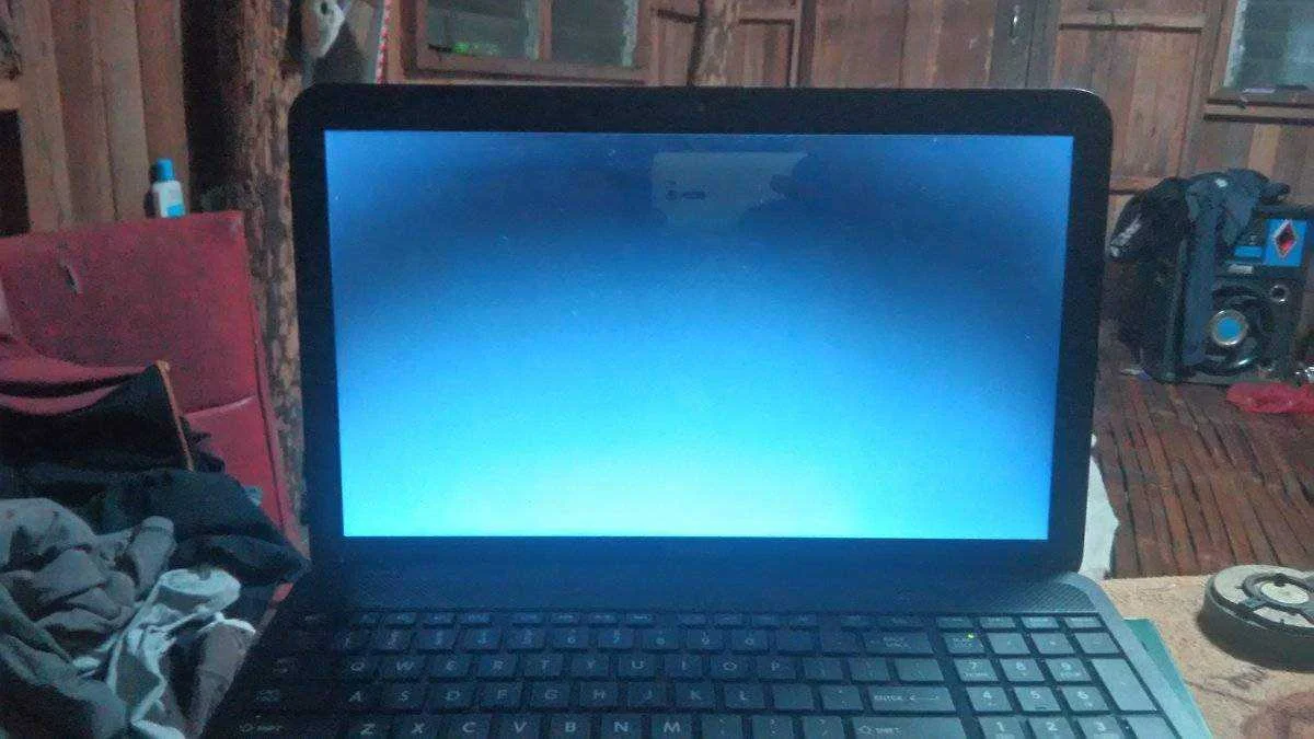

🔒 Closed White screen
Remove mu battery then plug charger tapos press mu yung ON ng 5 to 8 seconds . Pag wala parin try mu remove yung hard drive then plug pag wala parin lcd sira nyan . Kung reformat mu dpt makapunta ka sa bios settings
Ganito lng po sya
Try mo to gawin
Try starting up in "Safe Mode" and see if it will load correctly. If it does, then you need to do some cleaning while in "Safe Mode" to remove the software, malware, virus, etc., that is the cause.
How to enter "Safe Mode" when booting the computer.
In Windows 8 and 10...
As your computer restarts, press F8 (possibly a few times) to enter "Safe Mode"
a. Press the "F4" key to Enable "Safe Mode".
(The computer will then start in "Safe Mode" with a minimal set of drivers and services.)
b. Press the "F5" key to Enable "Safe Mode" with Networking.
( Once "Safe Mode" with Networking starts, Windows is in Safe Mode, with additional network and services for accessing the Internet and other computers on your network.)
c. Press the "F6" key to Enable "Safe Mode" with Command Prompt.
(In "Safe Mode" with "Command Prompt" starts Windows in Safe Mode, with a Command Prompt window instead of the Windows interface. This option is mostly only used by IT professionals.)
Now sign in to the computer with your account name and password. (If you have one set.) When you are finished troubleshooting, you can exit "Safe Mode" restarting your computer.
In Windows 7/Vista/XP...
1. Immediately after turning on the computer, or restarting it (usually after you hear your computer beep), tap the F8 key, repeatedly, in 1 second intervals.
2. The computer will then display hardware information and run a memory test.
3. Next the "Advanced Boot Options" menu will appear.
4. In the "Advanced Boot Options" menu use the arrow keys to select "Safe Mode" or "Safe Mode with Networking" and press ENTER.
If it still loads as white, then you are probably talking hardware rather than software issues. In that case, try this...
1. Turn the laptop off (not sleep or hibernate but off).
2. Connect an external monitor to the laptop.
3. Turn on the external monitor.
4. Turn on the laptop.
NOTE: You may have to press an "external monitor" button. Could be the f4 button or a button with two monitors on it, for the external monitor to work.
If you can see fine on the external monitor, then your attached display, or the ribbon cable that connects it, are your problem.
If you can't see on the external monitor at all, or the problem occurs on the external monitor as well, then it is probably the graphics card/GPU that is the problem, which may require the motherboard be replaced.
unplug mo harddrive mo then turn on mo computer mo. then kapag may nagappear sa screen something wala daw harddisk or whatever.. turn off mo ulit balik mo harddrive mo. then turn on mo ulit computer mo.
