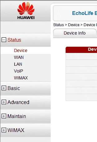

Now that you're able to log-in as admin.. You will see something like this..
to change frequency Select WIMAX tab, click Scanset and modify, it's simple, select the right frequency for your area and delete the other frequencies.. note that if you're unfortunate and delete the right frequency for your area you might not be able to connect again.. for beginners you should not give it a try to modify it..
