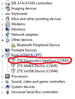

1. Install QPST, then Open QPST Configuration. (nakaplug na ang stick by this time) Go to PORTS Click "Add New Port" and select the port of your USB Modem (See Attachment). "EX: port:COM3, port label:COM3" (See attachment kung san makita ang PORT ng stick), then click OK. You should see there SURFXXXX under Phone column. Click "Start Client (nasa taas na menu bar)", then click "EFS Explorer". You will see there the port with SURFXXXX na label, click OK. You will be presented with folders and files. Do not touch the folders. Just to be sure, save a copy of the following files before you delete them, 9 files all in all (this will serve as your original SmartBro MF190 Files). You can save a copy by highlighting all the files then right click. After saving a backup, DELETE the listed files.

6. This time, unplug the USB stick, uninstall the 3 dashboards yung smartbro na dashboard, etisalat,and movistar na dashboard, then clean / fixed registry using ccleaner na software. You can restart your computer after uninstalling all 3 softwares to prepare for fresh install once ireplug natin ang USB Stick.
7.Ikabit ang USB Stick na MAY IBANG SIM maliban sa smartbro. Then mag-ooautorun sya para mainstall ang dashboard na "Mobily Connect Card" at corresponding Drivers. You will be amazed na accepted ang sim and merong signal. OPENLINE na SmartBro ZTE MF190 Stick mo!!
