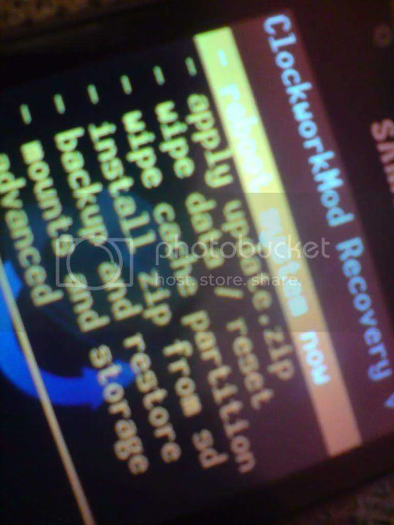

1.download cwm recovery mode install it to memory card also the custom rom

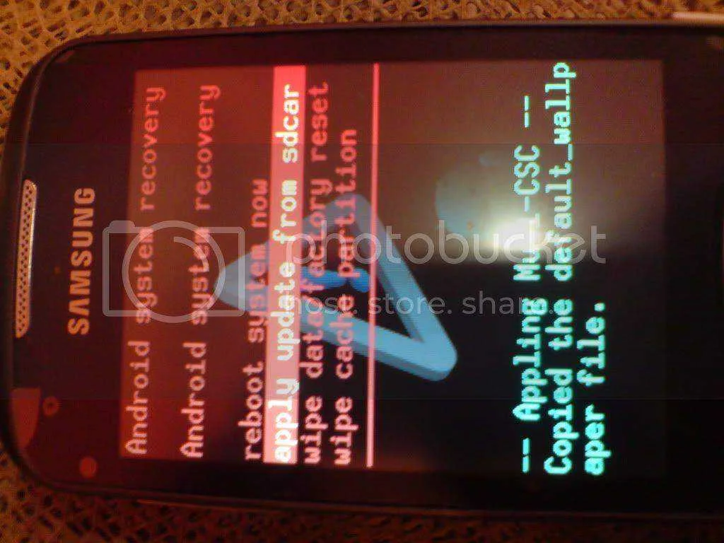

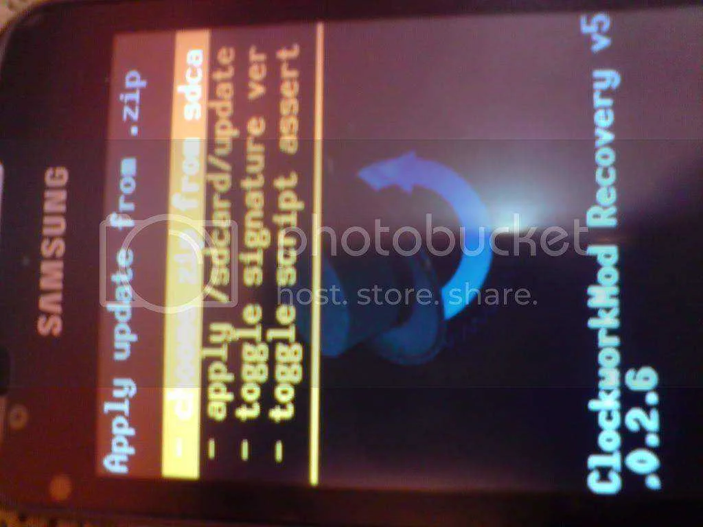

2.put s5570 in recovery mode by pressing volume up center key and on.
it will show like this
click center key for ok

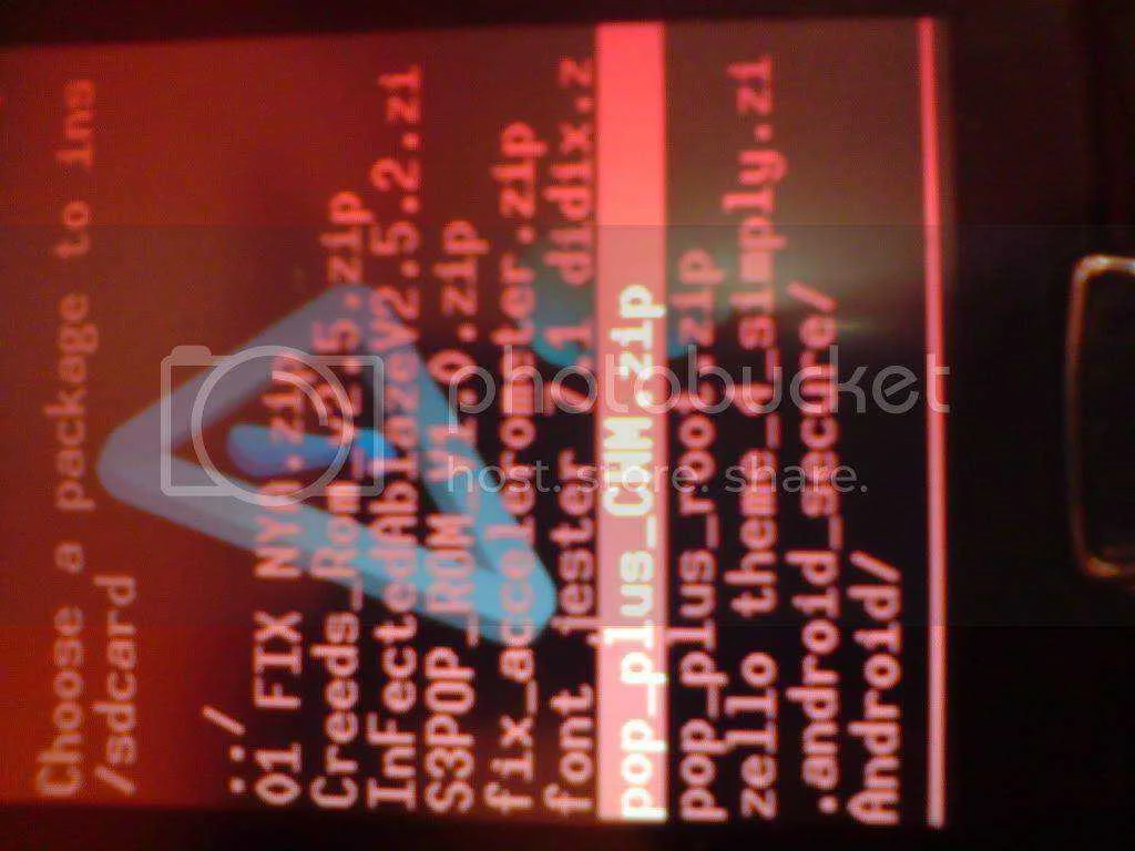

3. select pop_plus_cwm.zip (Clockworkmode recovery)

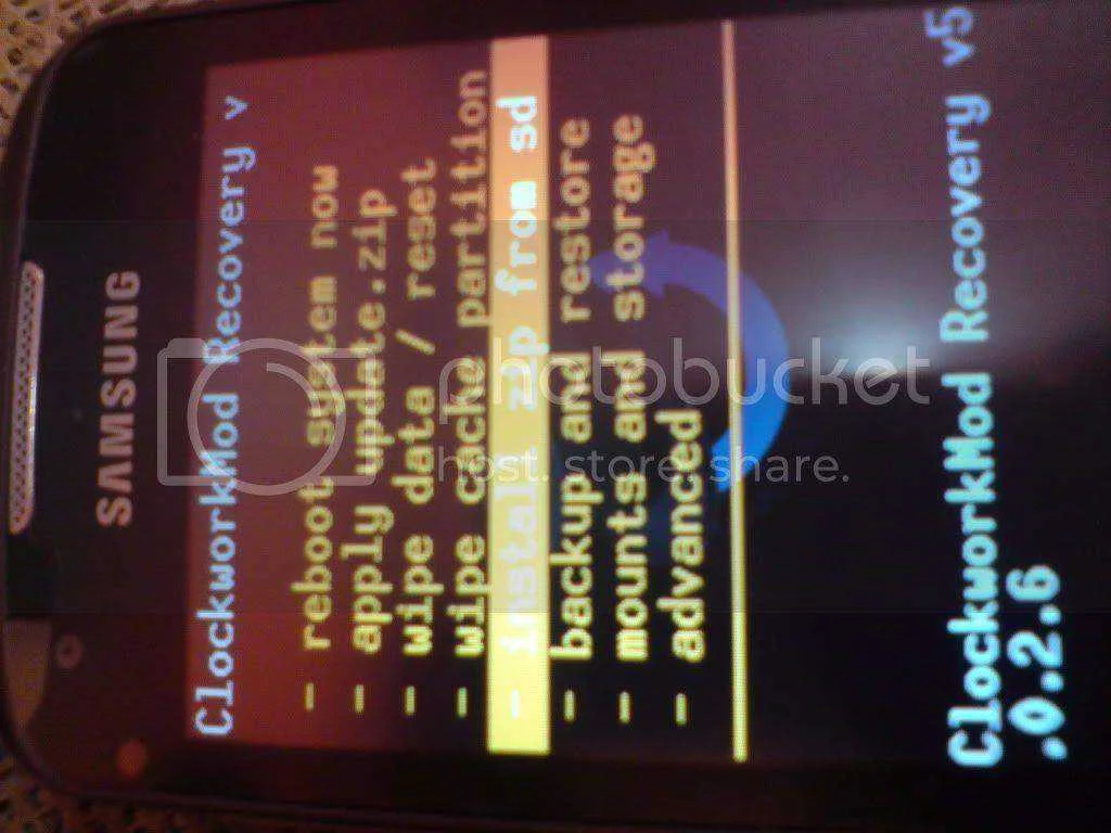

4. now image will show like this
5. select install zip in sdcard
6. choose zip from sd card

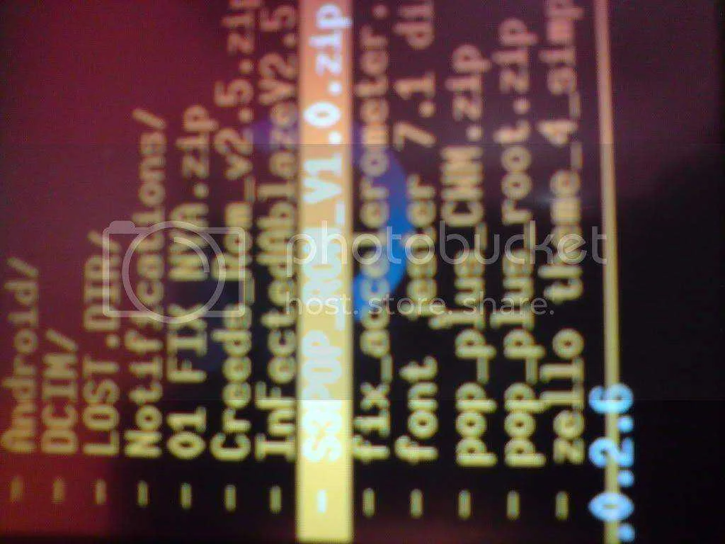

7. select s3pop rom v1.0 for s5570i
8. after selecting custom rom w8 till finish installing

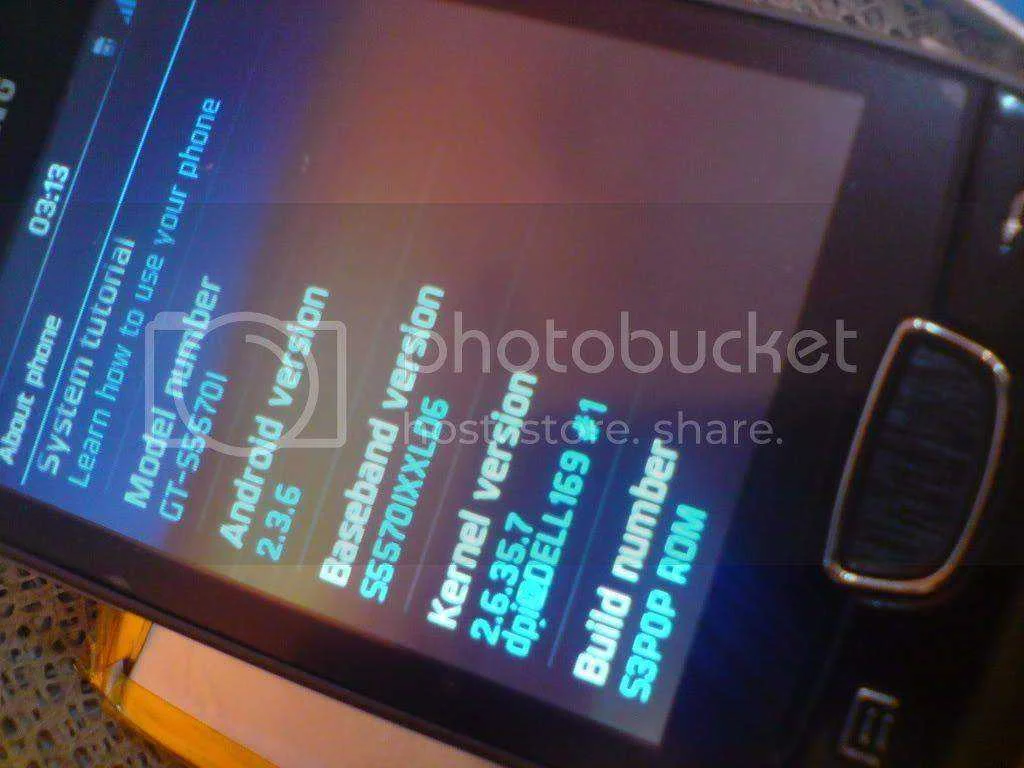

9. reboot system now

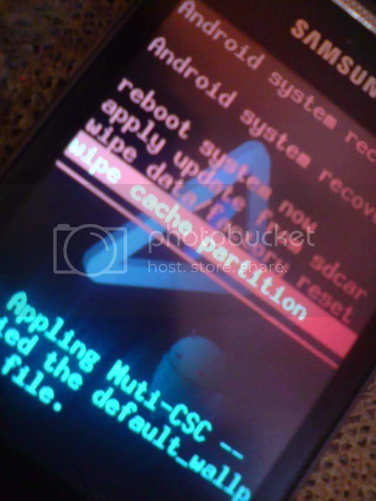

10. after reboot put s5570i in recovery mode again
and wipe cache partition
11. after wipe cache partition reboot system now

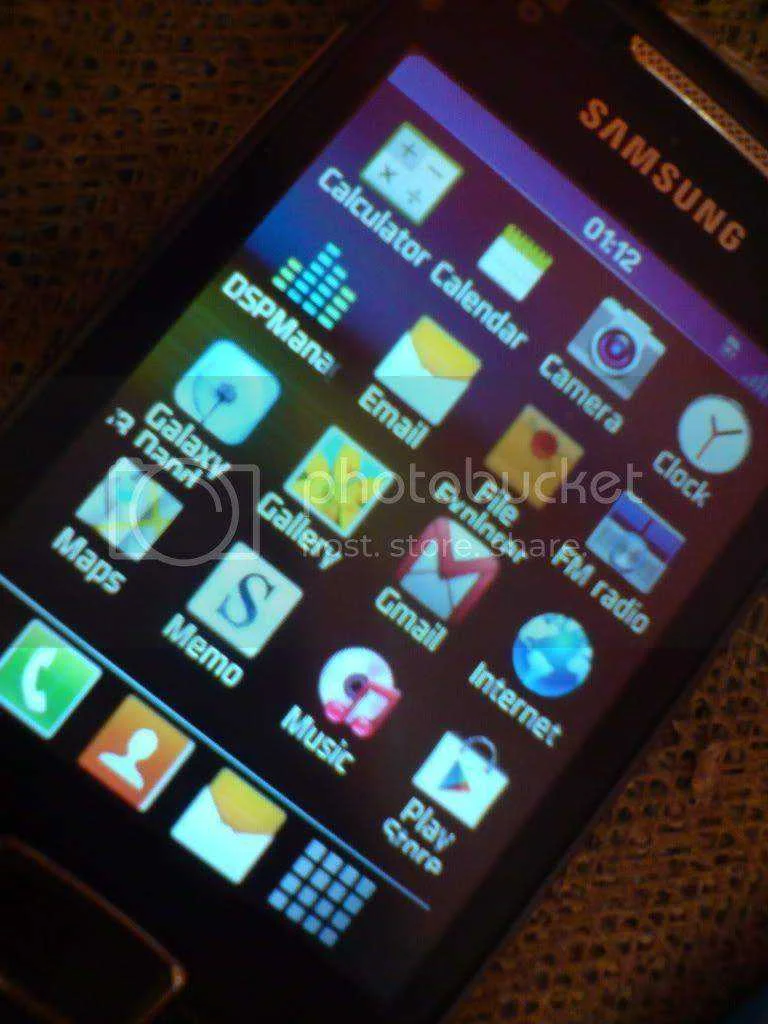

now w8 for samsung startup viola ur samsung back to normal w/ custom rom
