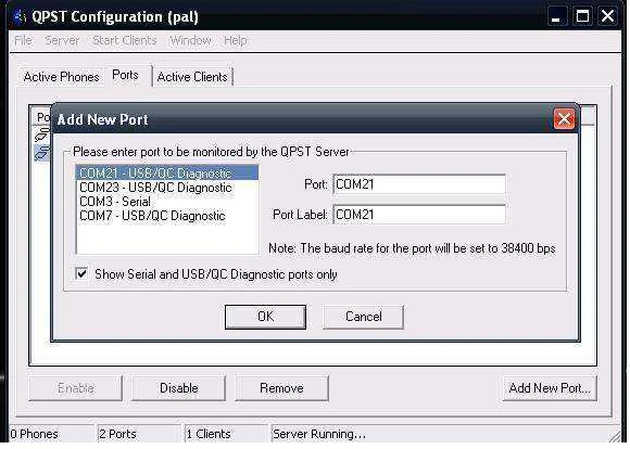

3. clik <start><all programs><QPST> open <QPST configuration>, clik nyo yung <add new port>
piliin nyo yung port kung saan nakasalpak ang modemn nyo then clik "OK"
HOW: ex: COM5 USB/QC Diagnostic
para sure: right clik computer icon>manage>device manager> Port (COM & LPT) para makita nyo port ng modemn

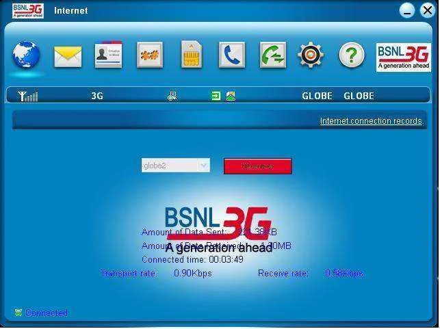

8.uninstall nyo yung dati nyang dashboard (yung orig dashboard) kung di pa na-uninstall at pakatapos install nyo yung "BSNL.MF180" for temporary dashboard.
9. pagkatapos open yung BSNL dashboard salpak mo yung modemn(wait until detected) makikita mo UNLOCKED na yan.PERO!

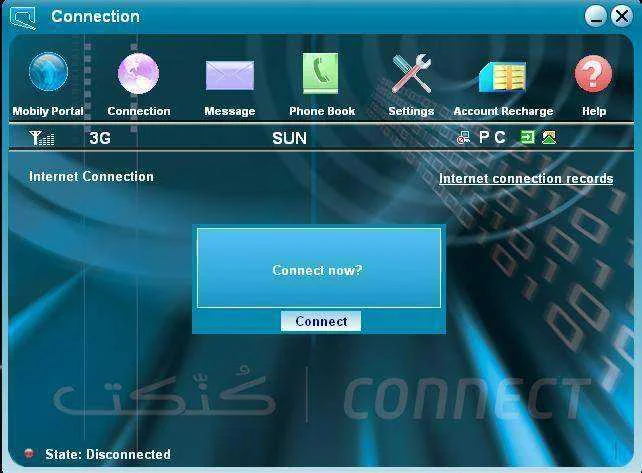

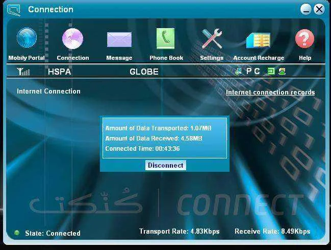

12. restart your computer, plug your new UNLOCKED MF180 and run installer...
ENJOY using any sim!!!:gangnamstyle:
