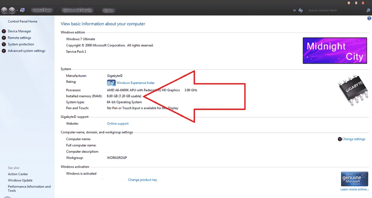

Hello Guys, Sana po tulongan nyo po ako nag ka problema ako sa Ram ko at hndi ko po alm gawin, 8GB namn yung naka install pero 7.20GB usable nya meron bang way how to fix it?

You can't disable it unless you have a dedicated GPU in which you appear to not have. You could only decrease the amount of memory the APU's using but I'd really recommend you NOT to. It's only 800mb. What are you trying to do that will require over 7GB of RAM? If you decrease the amount of memory the APU's using you're also decreasing the performance of your graphics processing power. That APU's already weak as it is
