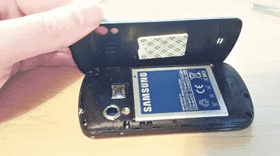

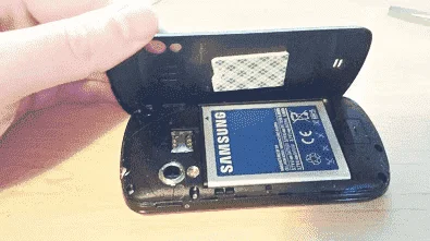

Cause #4 – Loose Battery
Of course, this problem only occurs on devices with a removable battery. My Droid 1 and Samsung Galaxy S4 were notorious for suddenly restarting. Sometimes they would shut off and never turn back on. It turned out that in both cases, the battery was coming a bit loose. Just a slight jab at the device would quickly unseat, then re-seat the battery, causing it to reset.
The most common reason for this is the rear cover has become slightly bent and is no longer holding the battery into place. Another reason is the gold battery connectors are bent out of shape. Over time, the connectors may get worn down.
There are two ways to tackle a problem with a loose battery:
  1. Purchase some mounting tape, then affix a small piece to an area of the rear cover so that it holds the battery into place better.

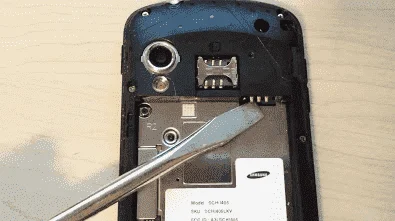

  2. Turn the device off, remove the rear case and unseat the battery. Locate the battery connector pins. If possible, use a small screw driver to pry the connectors into a position where they will make better contact with the battery.
