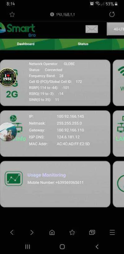

So here's the tutorial:
1. Lagyan ng ibang sim like (Globe/TM)
2. Open your wifi then connect mo sa phone mo or pc.
3. Open browser then type this: 192.168.1.1
4. Login mo kung hinihingian ka password. Usually nyan ay "smartbro"
5. Go to Internet > MEP Settings
6. Input this unlocker code "@2N@t1Tr3"
7. Click unlock.
The router will restart then you're good to go.
babalik ang wifi password nyan sa smartbro.
configure mo na lang ulit.
hit like if working.
feedback needed
