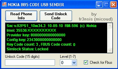

1. Download this program You do not have permission to view the full content of this post. Log in or register now. (Don't run it just yet.)
2. Download and Install the latest You do not have permission to view the full content of this post. Log in or register now. (This installs the phone drivers)
3. Connect your phone to the PC and select PC Suite on your phone screen, then wait for all the drivers to install.
4. Run the 'SendCodeUsb.exe' program.
5. Click the 'Read Phone Info' button to check the connection, you will also see some info about your phone.
6. Tick the 'Check for FBus' option.
7. Enter the unlocking code supplied into the 'Unlock Code (15 digits)' box. NOTE: only enter the middle numbers part
EG if your code is #pw+418636523456123+1#, then just enter 418636523456123
8. Next, select the Lock 'Level (1-7)'. this should be set at 1.
9. Finally Click the 'Send Unlock Code' button to send the code to the phone and unlock it.
Here's a view of the program running and connected:
